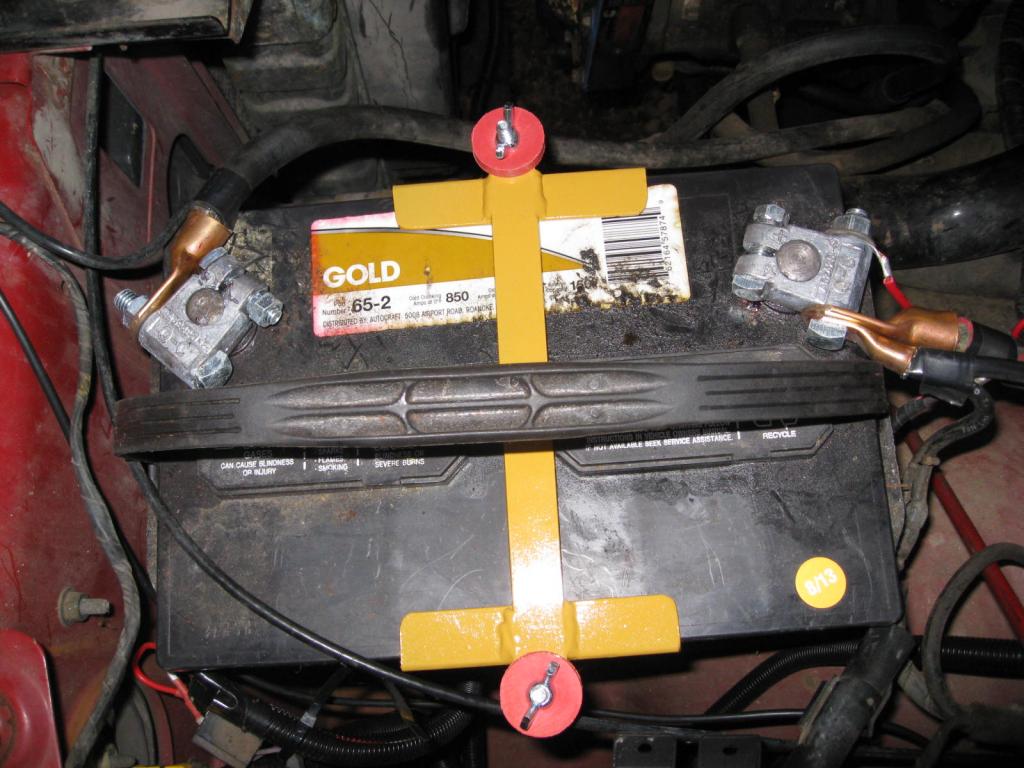

I needed a battery hold down bracket because the stock one rotted off. I went to the usual parts stores and found a lot of chintzy plastic crap so I decided to make my own. I used two 4" pieces of bed frame and 8.5" of 3/4"w X 1/8" steel strap. I drilled a 5/16" hole in each end of the strap centered 1/2" from the end. I rounded off the edges of the strap and welded the pieces of bed frame to it 7.5" inside to inside. Then I painted it YELLOW!!!
Way better than the aforementioned junk!

Nice use of bedrail. Thanks for the idea!

Lookin good.
No prob! I've used bed frames to build all sorts of stands, brackets, etc. I usually get frustrated when all I can find is junk plastic "universal" stuff and end up making my own. I also do a lot of my work at night after the parts store is closed so I kind of have to build my own stuff. Besides, I enjoy making my own!
