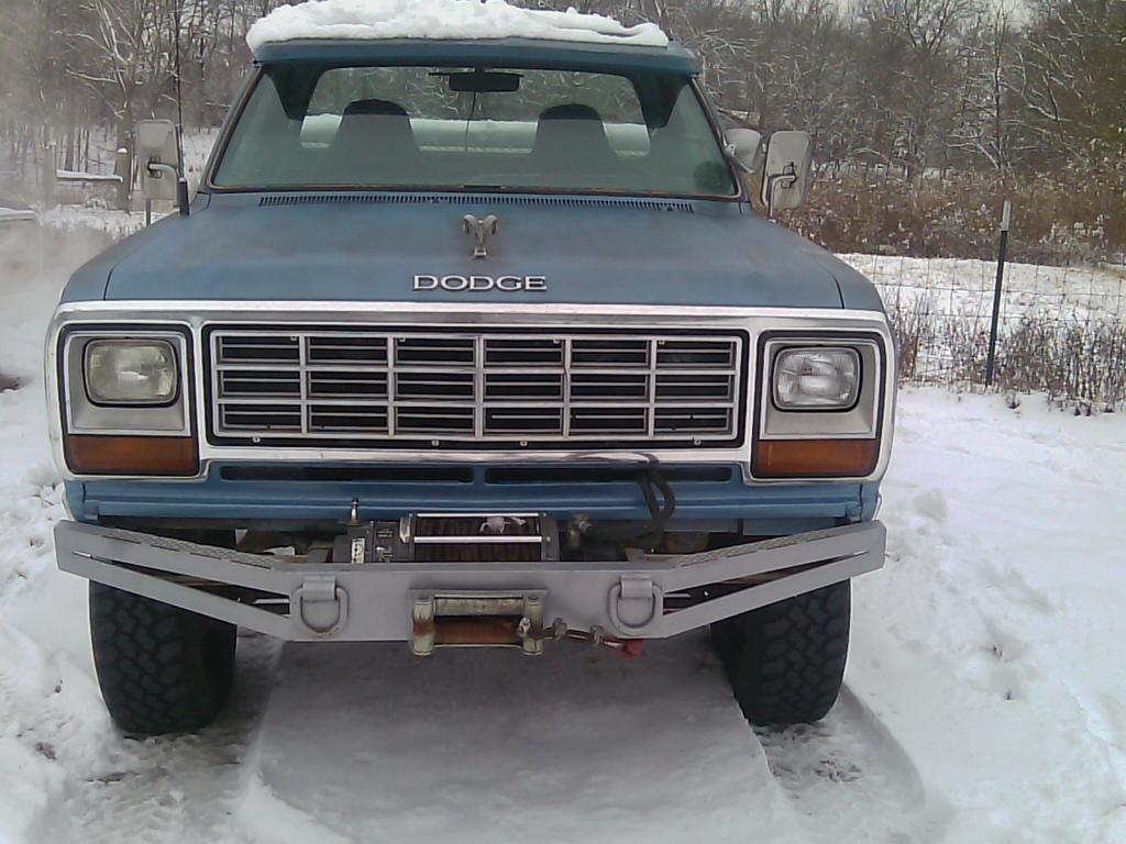

Here's mine. 6" c channel face with 4" c channel mounts that slide into the frame. 2" angle finishing off the sides. Some 2" angle bracing that ties the outer ends back to the 4" mounts. Simple, but effective. Don't know how dressed up you want it. I went for total utilitarian function over form.
I like to look at what people have done. and get ideas from different ones.
Yes yours is utilitarian and it gives me ideas.

Great fabricated bumper flyboy. Very creative and utilitarian. Probably enough room to mount...never mind
