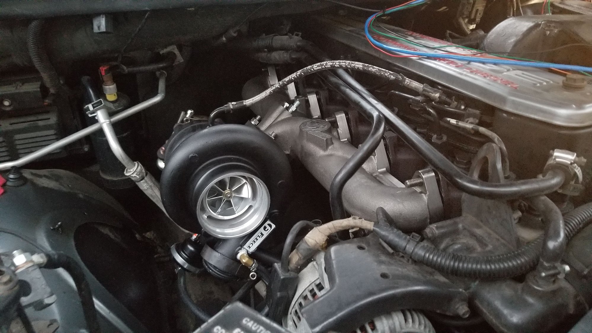

Old May 18, 2018 | 09:51 AM
cfm56's Avatar
Joined: Sep 2017
Posts: 35
I'll tell you how good a fleece cheetah is in a day or 2 after I get it installed and run it.
On my completely stock 12 valve, might have to tune up the P7100 afc to get it going.
FYI: its a Holset hx35 that is upgraded so its direct bolt on.
Max boost is 40 PSI on stock studs. Thats what I've heard, the cheetah is wastegated to 30 PSI.
