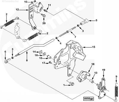

Does anyone have the "Throttle actuator rod" part number for a 97 Dodge 2500? I bought the ends but the rod is rotted/bent slightly.
Old Jan 28, 2009 | 10:19 AM
GAmes's Avatar
Posts: 1,269
From: Killeen, Tx
A few years ago I bought the entire assembly from a Dodge dealer for about $40 IIRC. Cummins Quickserve shows it in graphic tl950gp, option TL9057 but does not show the individual part number.

Give a call to Cummins SW and tell them the serial number of your engine. They have the break down of the graphic I listed

I did mine before the recall and the kit included the rod, in fact part number CANZ9700- Throttle Control Cable & Linkage Package contained the following:
1 - Throttle control cable
2 - Throttle rod ball studs
2 - Throttle rod ball stud nuts
1 - Throttle control cable ball stud
1 - Throttle control cable ball stud nut
1 - Short R/H threaded rod end
1 - Short L/H threaded rod end
1 - Long R/H threaded rod end
1 - Throttle return spring
Chrysler paid me back $38 for the parts later after the recall came out.
