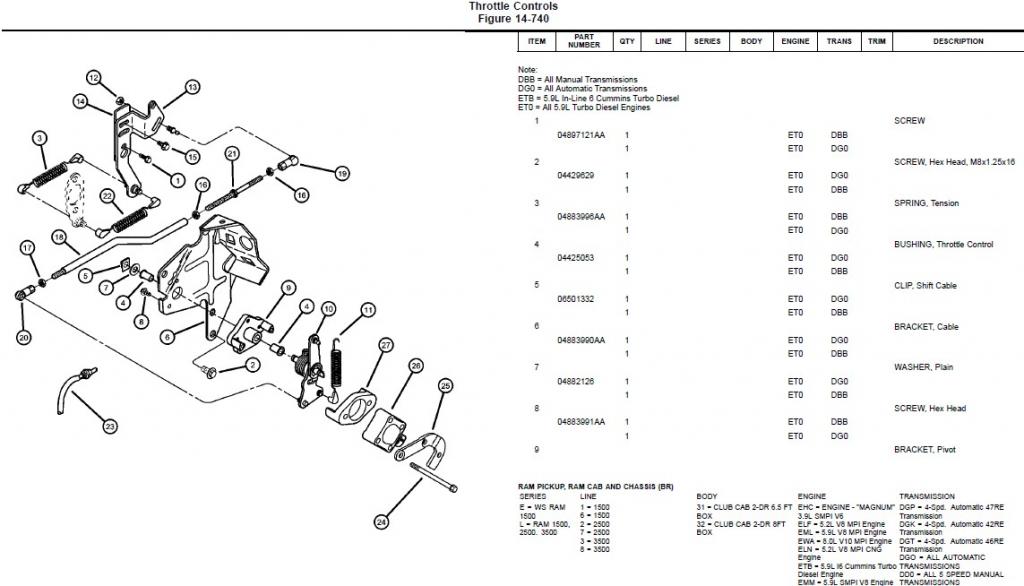

I've got a 96 12v that's been sitting a couple years. After some tinkering starts right up. But the throttle is binding. Its not in the arm and ball linkage. Seems to be in the bracket assembly with the return springs. The one all the cables feed into. Has anyone had this? Freed it up? Or is there a part # to replace?

If you mean the actual bellcrank assy, then there is a bushing that should prevent that from happening, It is easily rebuildable though, Goerends website has an excellent video detailing it since being worn out can cause hunting.

Here is the page out of the parts manual......
