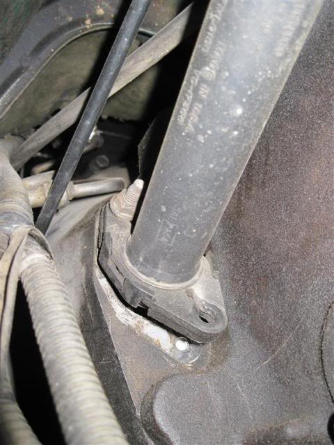

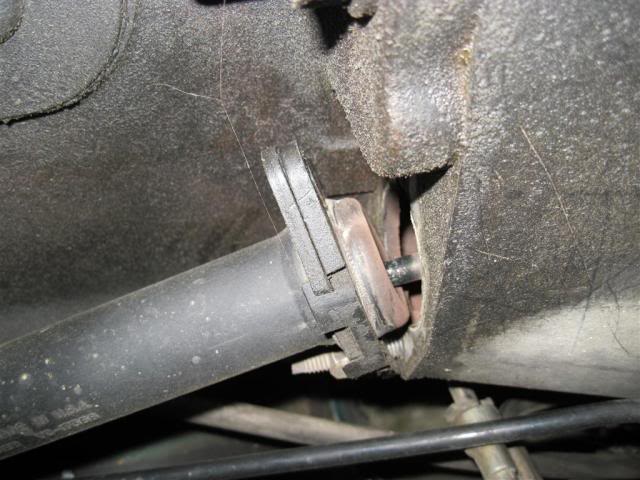

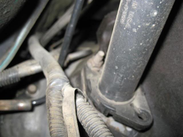

I think I JUST MIGHT have found the problem.
Awesome, looks like the bolt actually broke off leaving part of the shank in the threads. And there's no part left sticking out to weld a nut to to get it out... there goes the easy method.
Wonder how the heck that broke off.

u might be able to tap it out with a chisel or center punch. that or drill it and tap it again. there are some special kits from the hardware store that might help.

Left hand drill bit will be your friend on that one.

I drilled into the stud and then used stud extractor bit and it came right out. Didn't think I'd have room to get in there with my smallest drill but there was just enough space to work with. Got 2 new bolts and put them in along with some threadlocker this time and all seems to be good.
