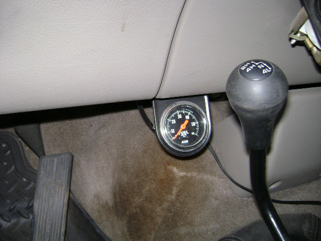

Even though my new gauges have lighting I didn't hook it up. FP isn't something you have to watch all the time. For that reason also I have my FP gauges mounted low on the dash just ahead of the 4wd shifter.

Infidel - Thanks for the clarification with additional details! That is the info I was looking for. The gauges I have been seeing online dont include the nylon tubing or compression fittings. I take it Napa will have the compression fittings I need for the connections at the 1/8 NPT fitting at the needle valve and the back of the gauge? I will be getting the Genos snubber and the needle valve you referred to at Graingers. I will be going the same route as your install right down to the gauge mount location by the 4x4 shifter. I was thinking that is the perfect place for it as well. I was hoping to get a couple photos of your gauge mounted there. I would appreciate it. If possible, I would like to use the couple of factory screws that secure the plastic panels. I am **** about clean installs and strive to minimize drilling when I can.

Sorry, went out a couple of weeks ago to take a picture of my gauge and discovered the camera no longer worked.
Now it does though...
