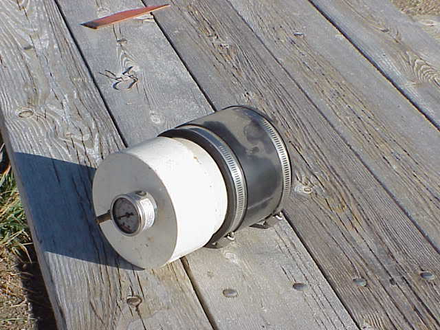

Make a boost leak tester like this to clamp to the inlet of the turbo.

ok i will. i just put a new boot on the lower pass side when i did head gasket. what did you use for that tester? that balloon sound is exactly what it sounds like!

My tester is much the same as above. What you mainly need that is somewhat special is a hose type drain line coupling, 4"idx4"od
I bought mine at Home Depot for $8.
Rest of the items are common, short piece of 4" pipe and a cap.

ok i see what you all are talking about i can whiip that up. i disconnect the pipe from the turbo and put this on there to pressure test the system intercooler, intake and ect?

Yep, it goes on the inlet of the turbo, so the "pipe" you take off, is the intake filter to turbo "pipe".

One safety precaution I found out the hard way, the tester can fly off like a missile under pressure even with the clamps very tight. Turbo inlet isn't normally under pressure so it's not designed to hold the tube on.
I've taken to looping some baling wire from the wastegate to the chuck on my tester for a safety harness.

Good call!!! It's very true!!! I've had it happen even at lower pressures and smaller turbo inlets(smaller surface area) for gas engines and it can definately hurt you!

thanks guys i found it one of the boots wasnt clamped good. it didnt make ne noise till bout 15 lbs. thanks the set up worked like a charm.
