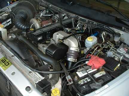

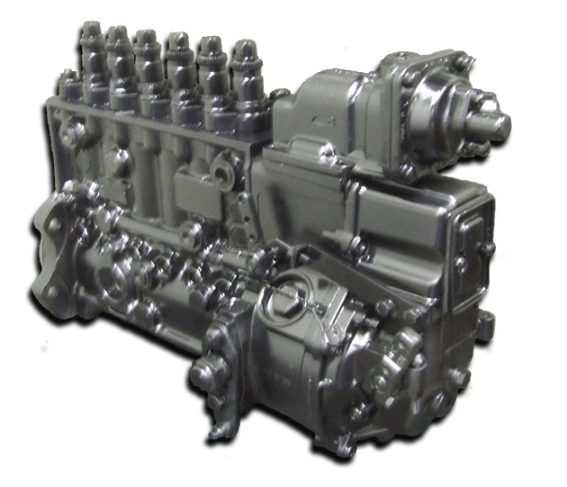

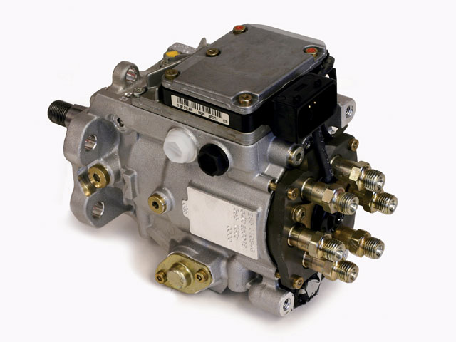

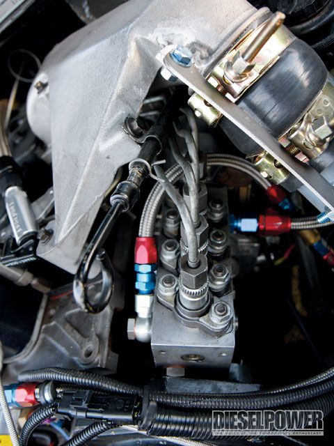

first two pics are a 12V with the p7100 injection pump. second are the 24V with the VP44 injection pump. these are one of the easiest ways to tell them apart.
Attached Thumbnails early or late '98?-0907dp_04_z-1998_ford_ranger-p7100_injection_pump.jpg   early or late '98?-ppump.gif   early or late '98?-figure1_small.jpg   early or late '98?-0706dp_09_z-diesel_fuel_injection_tech-bosch_vp44_injection_pump.jpg
Great! That's exactly what I was wanting to know. That is a great help, thanks. Since I first turned a wrench in the late 1960's, I've seen all sorts of amalgamations of parts. Less desirale engines will be put in if that's all the owner has handy and he or she is cheap, or broke. This is why I signed up with this site. I did hear about the seller of the truck I plan to look at next weekend. He sometimes is a bit shady.
