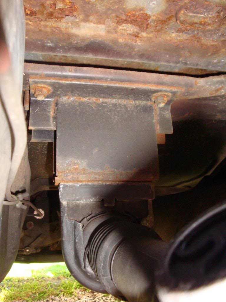

I have taken it upon myself to try to squirt some white lithium in there when I grease everything. I also built a different bracket to accomodate the more common bearing, has mounting bolt "ears" on the side instead of bolting into the bearing assembly from above. Makes the swap about $30 cheaper when I am due.

Could you post a picture of your mod so I can do the same ?

I have to crawl under there to measure for new e-brake cables tomorrw anyhow, will post them up then.

Well I went for a look the other day and it seems like the new bracket I made is just for the stock replacement bearing. Must have had money that week.
Now that I think of it for a while I had the other type bearing (with ears on side) mounted to the stock bracket, welded some 1" tubing to it to make up the difference in height, and to have something to bolt to. The OE hanger bracket was getting a little thin from corrosion so I made this.
If you have either a brake and some 1/8 sheetmetal or some angle iron/flat stock and a welder you can make whatever you want work.
