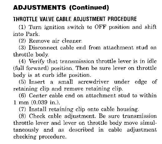

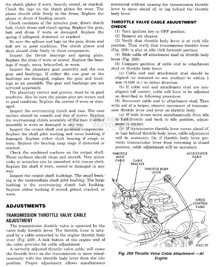

Originally Posted by Louie Davino
Thanks for the help guys. Where on the trans is the governer solenoid and transducer? and what kind of adjustment should the throttle valve cable have?
Solenoid and Transducer are inside valve body, not hard to change but messy.
Lets see how this works for showing TV adjustment and operation.
See how that works for you, if you cant read the first one let me know and I can break it up.
'96 12 valve auto trans holds 2nd to 3rd shift-97tv-cable-adjustment-procedure.jpg
