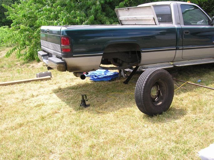

In 2010 I put a 2001.5 Dana 70 3.54 disc brake rear-end under my '95 2-WD 2500, and it's one of the best upgrades I ever did. I got it from DTR member RedlineAR, who runs a Dodge/Cummins salvage yard in Hartman, Ark. and who sells on ebay under the name RedlineAR. It is a Trak-Lok rear-end.
Reason I put it in is that I just got tired of the drum brakes never self adjusting. Or sometimes they'd over-adjust and I'd be running with a smoking drum. Braking is so easy now. Used to be I'd have to practically stand on the brakes--the fronts were doing all the braking, but with this rear-end the braking is spread around to all 4 wheels.
The 2001.5 and 2002 Dana 70 disc brake rear-ends are direct bolt-in swaps for the drum brake Dana 70.

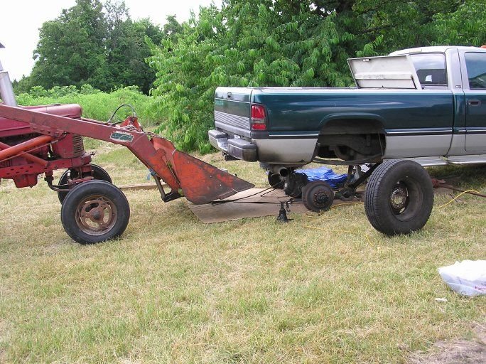

Here I've moved the 2001.5 rear-end into position. I carried it over with my front end loader, and then used a 4X4 to lever it into place.
Here I've got it in and installed. I had to get rebuilt calipers for it.
The tire does stick out a little further than on the drum-brake rear-end, but that didn't bother me.
