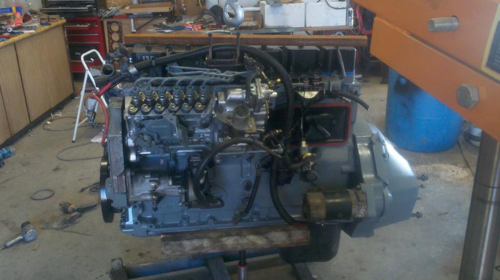

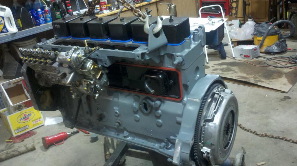

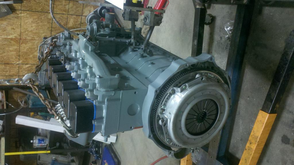

Here's a few pics.
Attached Thumbnails 12V Rebuild-Ready to start-2011-03-22_16-59-44_653.jpg   12V Rebuild-Ready to start-2011-03-22_16-59-28_484.jpg   12V Rebuild-Ready to start-2011-03-23_13-57-28_262.jpg
