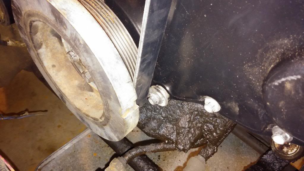

Q2 where on earth does this go?

Can't really say mine has anything like that. Is it round or oblong?
On edit, check this out, could it be index 17? That would be for an automatic truck.............

I saw one of those on a 4bt once, I say the trash

That is the bottom belt guide on the drivers side

The long bolts go in where the bolt holes are bored thru to the block

haha, no but I would be! It was in the same bucket as the cover bolts, so has to go somewhere- maybe near the crank sensor bracket?

I got a good part done today! Crank seal installed (forgot the lock tight though) and the cover went on smooth- I had my doubts with that plastic crank shield's outside diameter but it worked perfectly. I have 3 sizes of cover bolts, lots of short. One medium and a few long. Plus the stud's for the crank sensor. Where does that medium bolt go?

all back together, found that the spacer goes to the right of the crank-
