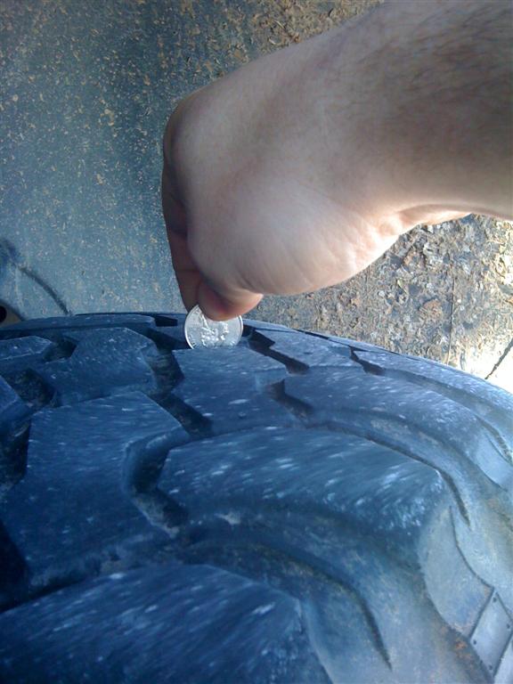

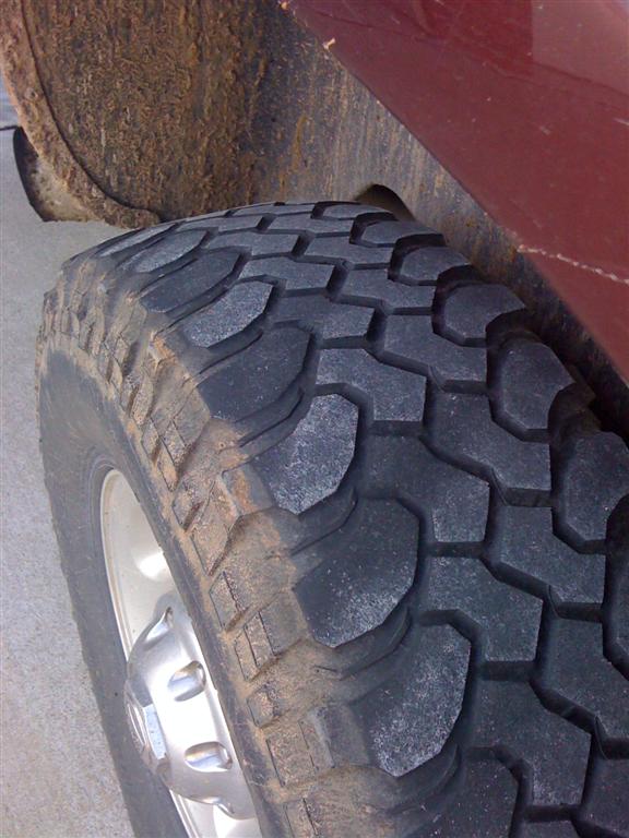

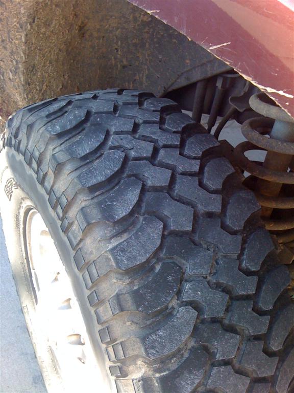

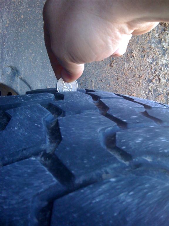

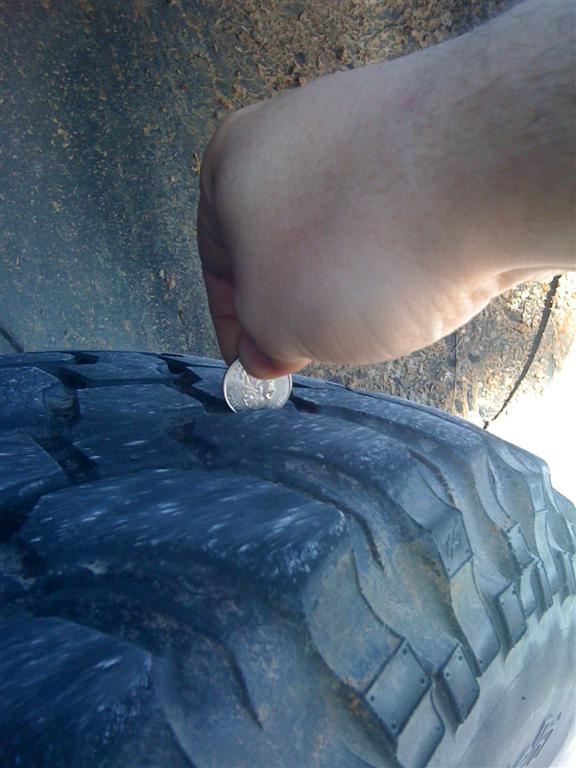

As for the tires, I'll have to check out that shock this weekend. In the mean time, here is what the wear looks like.
Inside edge
Middle
Outside edge
Front tire - kept at 60-62psi
Rear tire - usually running about 45psi, they have 52psi in them right now because my ATV is in the bed. You can see the wear on the lugs based on which ones picked up dirt from the driveway and which ones didn't. This had been on the front prior to my last alignment about 10K ago.

Golly Justin - the front tires on my '98 have been doing that since it was new... come to think of it - the '05 is the same way!
Darn solid front axles - the BJs suck.

I just hate having the outside edge of a tire be bald, while the inside (and all the others) still have good tread.
I was hoping you wouldn't mention ball joints. Didn't want to have to deal with them again...

When mine had the same wear patten as yours, a front end alignment fixed it. I was surprised at how much wear there was in on 5 or 6 hundred miles. Guess that old, heavy Cummins takes it toll on the front end.

Last time my tires chopped bad like that it was the ball joints Chopped them bad in little time... Believe it was only one edge as well...

Wouldn't sloppy ball joints be more likely to wear the inside edge?
If it's just one side, as you say, my vote is still the shock!

Well, then I guess it's time to check out the ball joints. I want to get this taken care of before I swap to my other set of tires. I'd rather not tear up the other set like this.

Will bad ball joints make the rear tires wear on the outside as well? All 4 of my tires are wearing on the outside edge. I just changed out the shocks about 1 month ago and they still wear on the outside.
