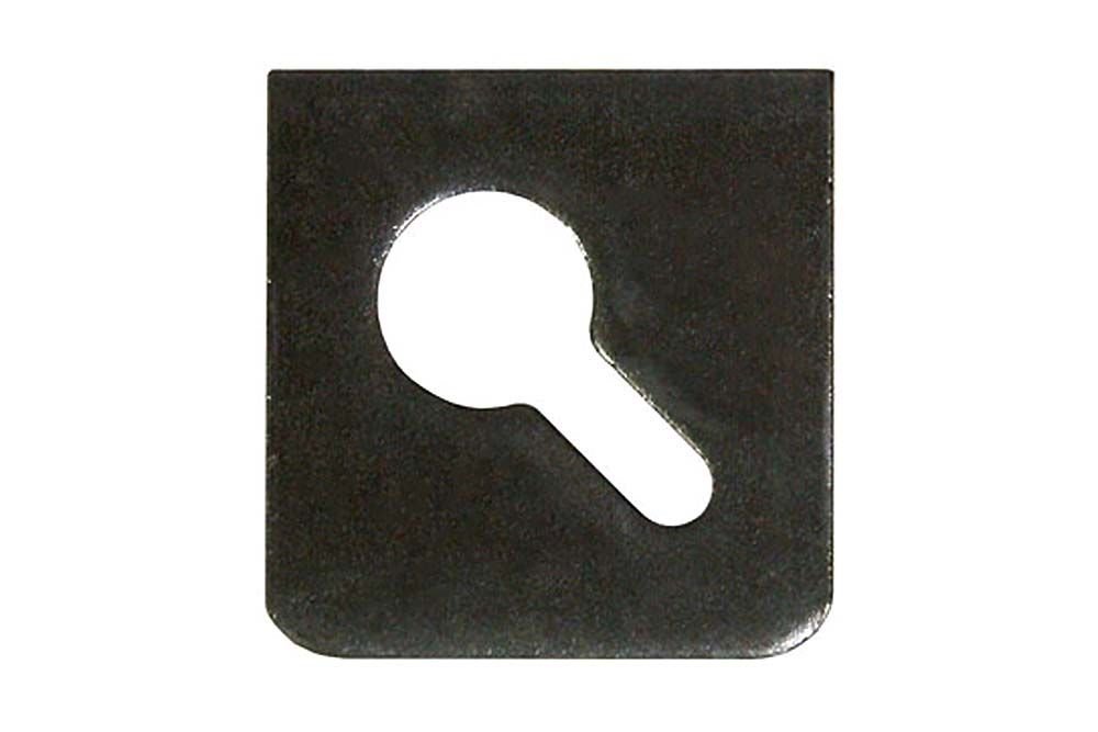

Steel or wood deck?
Tow trucks have key shaped holes cut into the deck to allow chain to drop thru and then lock into.

It has a wood deck because of the skid steer and muddy tires... I like the idea of the key hole welded to the frame standing upright, I had seen some that were just holes but this would mean I could use a short length of chain and have it easy removable.

Might be tough to get the chain to stay in the slot if the plate is mounted vertically and the slot is pointed up at a 45* angle.

Unless I come across another idea I'll probably use the keyhole slot you suggested, I would have the slot horizontal and the slot toward the front, this will hold a side to side and a forward force as in a violent swerve on sudden stop, the frame rail is under 2 inches wide so there isn't much to attach to if I lay it down flat. I need to give it more though.
