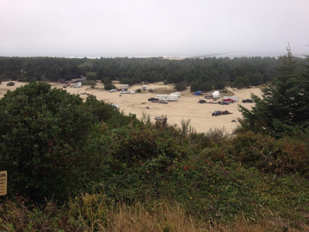

This was taken on the beach in Oregon 200.00 a pull to get un stuck out of the sand .... Ha
5 cats working pulling people in and out .
We watched for a while great entertainment , three axel fifths heel trailers with no air in there tires being pulled buy trucks out of the sand onto the pavement!
