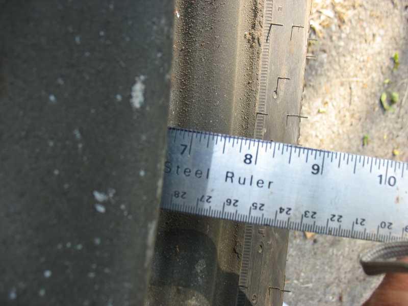

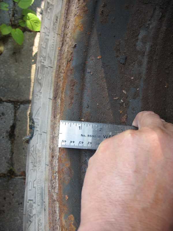

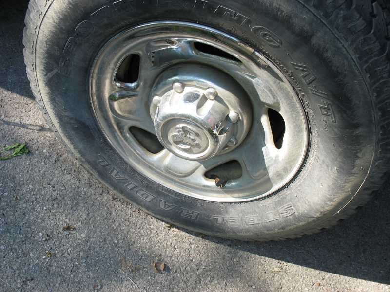

Actually, I probably have the steel-chrome wheels and not the alloy as I was thinking. I took pictures of the spare tire rim (original with the truck?) as well as one of the wheels that's on there. Plus pictures of the ruler measurement of wheel width (from edge to edge I read about 7.5", and not 6.5" as the door jamb label would indicate). Maybe I'm reading it wrong.
Anyway, all this to hopefully allow someone to tell me just what size wheels I have on there, so I can choose suitable tires to match.

p.s. Just checked the build sheet for my truck and it states 16x6.5" wheels, so no matter how I measure it, I have 6.5" wheels on there. Sorry for confusion.
