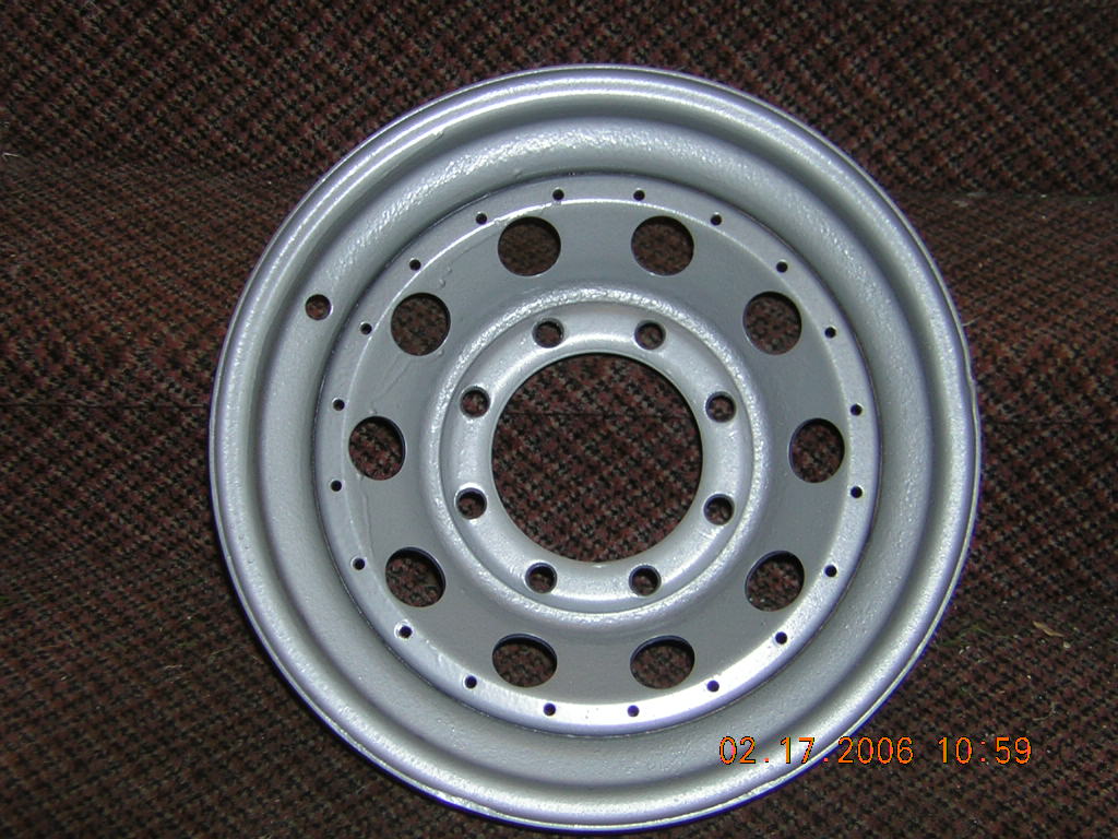

I have used POR15 and Rust Bullet and enjoyed Rust Bullet a lot more!!!!
Rust Bullet is some potent stuff. You do not need to surface prep other than simply degreasing/washing (whatever you like to use) and you do not need to top coat period. Just 2 coats of Rust Bullet.
This wheel was completely rusted over and has 1 coat of Rust Bullet. Unfortunately I am an awful painter and you can see huge clumps of overspray.
http://xj.cdevco.net/auto/nobed/DSCN0714.JPG
