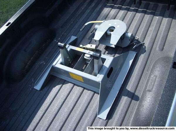

In this photo you can see how it attaches, and you can see the top draw down bolt and part of the two U bolts.
To me, that draw down bolt is just too critical to not use a torque wrench. I just keep a crafstman click type under the rear seat, along with a cheap-o set of deep wells...
IMHO that's really the only disadvantage to the B&W (having to use tools). It has a lot of positives, like leaving the bed flat when removed, pivots 4 ways, good range of vertical and fore/aft adjustability, and it is easy to visually see that the jaws are on the groove of the king pin.
