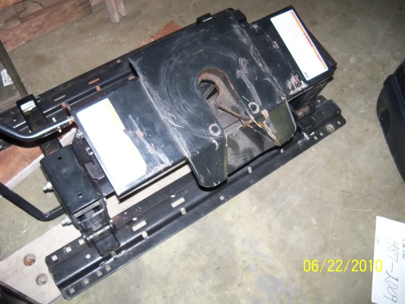

well i found a reese 16000 pound one with the slider on craigslist for 350 and i seen that they make a motorized slide attachment for it for like $250 anyone have one of those or know how it works? heres a pic of it and it seems to me like it hasent got much use on it. it also comes with everything the head slider and universal rail kit.

well now after searching on here some more i found that i should not drill the frame on my truck?!?!?! *** these things are a lil confusing. now should i buy a clamp mount rail kit for it and if so will they all work or do i have to get one from reese. any suggestions??? thanks alot!

well i pick up the reese for 350. it looks pretty nice not much use on it. i have all the bolts and brackets that were used on a chevy. it is the universal kit and i noticed that theres a few spacers diffrent for the dodge that i need so i emailed reese to see ifi could just buy the bolts from the kit. if not is there another base rail kit you guys would recomend or do i have to use one of the reese kits. thanks for all the info so far.
