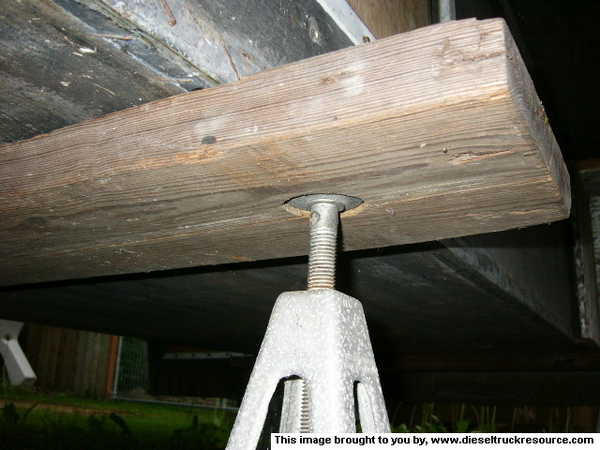

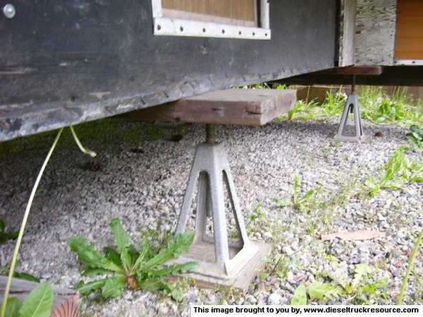

Here is what I did to set my camper on, both here at home and when camping, since we usually stay for about two weeks at one place.
I got four trailer stabilizing jacks, the ones with the square base and adjustable screw on the top. The flat top of the screw is about 2 1/2 to 3 inches in diameter. I then cut a 2X10 into two pieces, about 5 feet long. I measured and drilled two shallow holes on one side of each 2X10 for the flat tops to fit in. I also cut four squares from 1/2 plywood, just bigger then the base of the jacks for the jacks to sit on, on the ground.
When I unload my camper (a 10 footer), I lower it down so it isn't so unstable, then I place the plywood pieces with the jacks on them, place the 2X10's on top of them and lower the camper onto that. The 2X10's go side to side. I place one about 2 to 3 feet from the front of the camper and the other about the same from the rear. I then check the levels, and then jack up the camper just enough to use a long screwdriver through the hole in the adjustable screw jack to raise or lower enough until the camper is level. It doesn't take a whole lot of time, and the nice thing about using this system is that it is compact and light weight. I remove three of the adusting screws and nest all the jacks together. I store the 2X10's under the camper while it is on the truck, so very little storage space is used for this system.

Are these the jack stands you have?
Sorry it took me so long to reply. Had to take the pictures, then had to wait for approval.
Yes, that is the type of jack that I use. I cut a piece of 1/2 plywood just bigger then the base to set them on.
