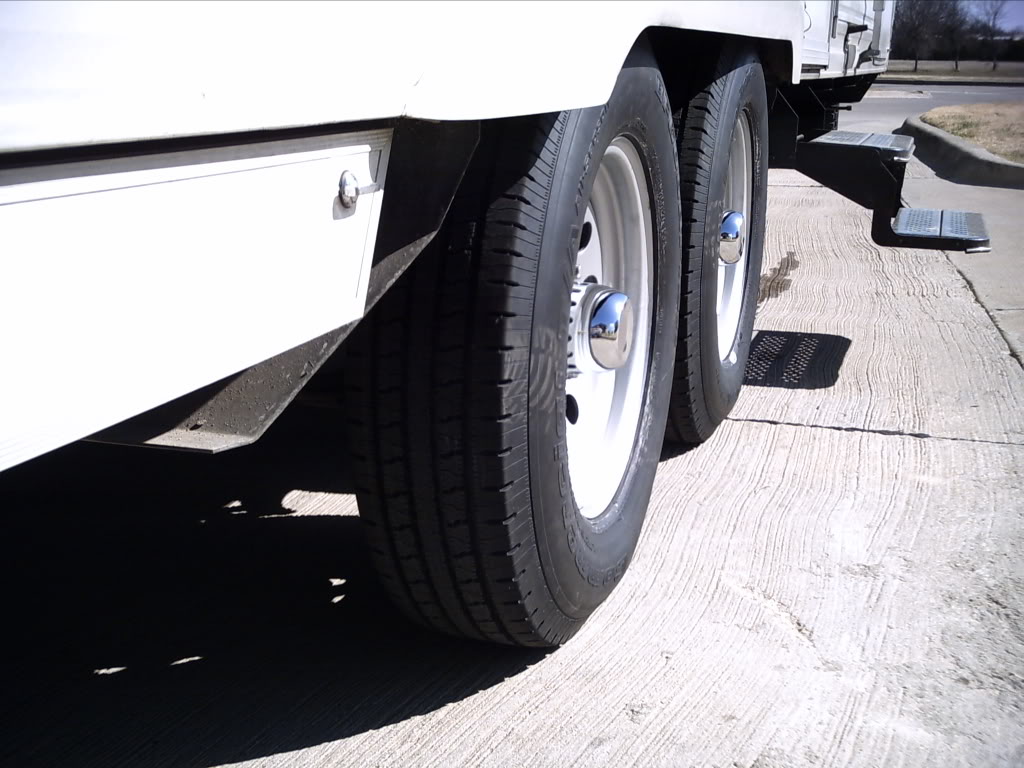

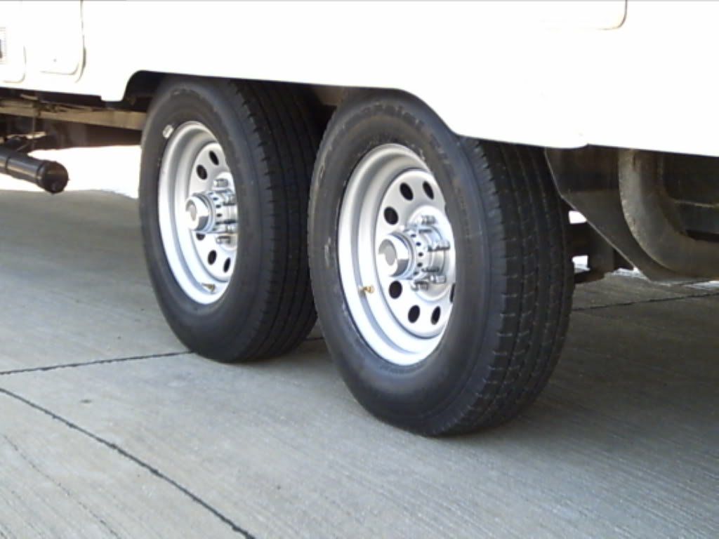

I am running 16'' BFG Commercial LT 'E rated' tires on my toyhauler. They run great! I feel much more confident in them than I did my chinese made ST tires.
