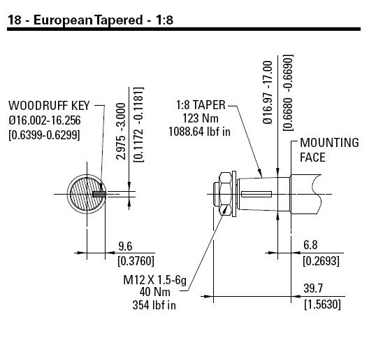

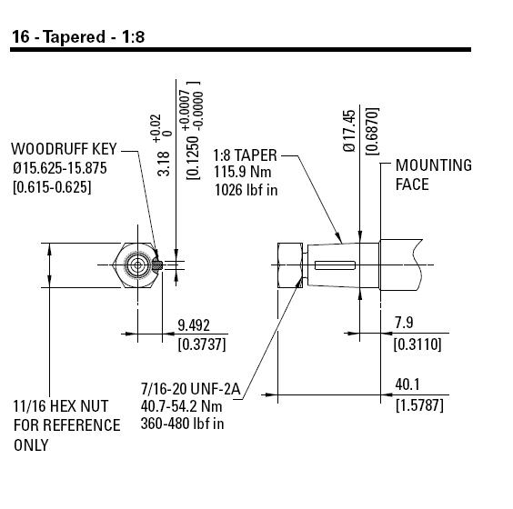

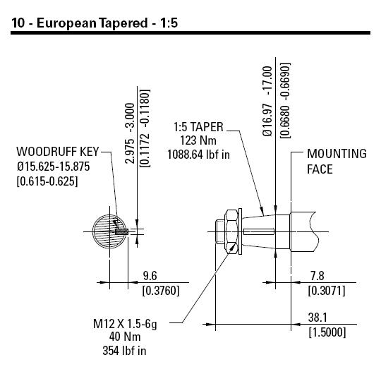

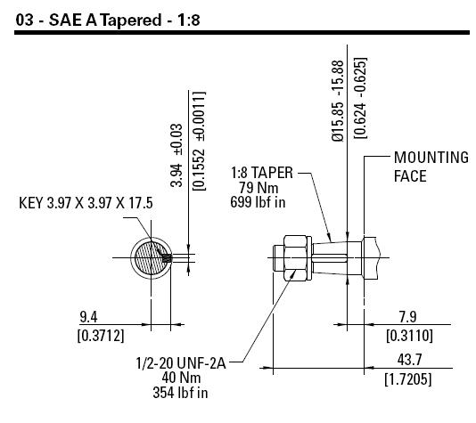

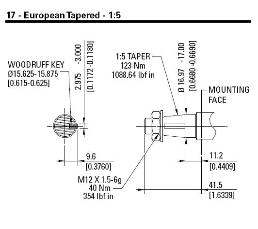

Dang, I can't figure out which one it is. Im trying to replace my vac/ps pump with a dedicated high flow hydro pump to run a bunch of stuff. here are my options for shafts. which one do you think it would be?
Attached Thumbnails Vacuum pump gear help-shaft.jpg   Vacuum pump gear help-shaft1.jpg   Vacuum pump gear help-shaft2.jpg   Vacuum pump gear help-shaft3.jpg   Vacuum pump gear help-shaft4.jpg

Contact Pete Gould at fixinrams.com. Pete is a major source of remanned vacuum pumps. A hydraulic pump without a large reserve tank and a recirculation circuit will burn itself up before driving 50 miles. There is a belt driven hydraulic pump available from Northern tool that can be turned on and off with an electric clutch like an a/c clutch; flip a switch for hydraulic service, flip a switch to turn it off. Just a suggestion.
