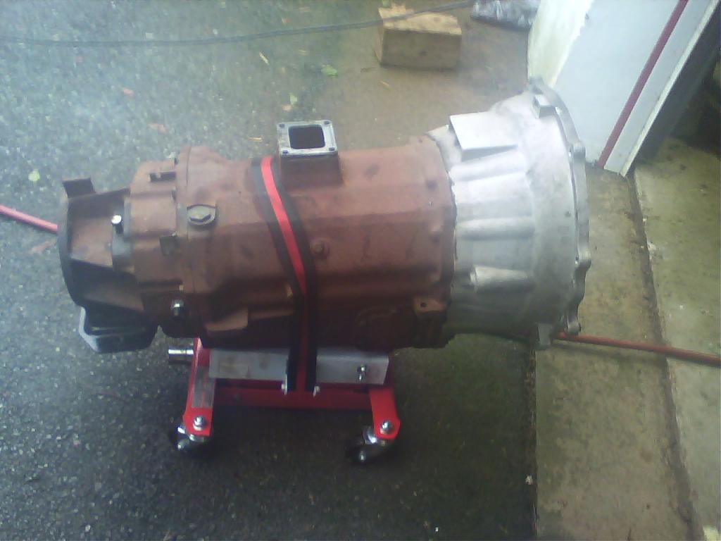

I have the same Harbor Freight trans jack. Probably some of the best money I spent. Its been used MANY times now. Just be careful when you lower the trans with it. The 1st time I used it, I put the air impact on it in recerse, hit the trigger, and down she came FAST!!

Well I got the South Bend flywheel, clutch, pressure plate and t.o. bearing in, I was amazed of how much grime was inside the bellhousing. I cleaned it all up and finally got the trans up and in. I will say it was the hardest/heaviest trans I have ever done. Would of been near impossible without a trans jack. I had to use the trans jack, floor jack and my trucks bottle jack to get it in. I worked on it yesterday for a few hours and it wasnt going in, I decided to try today and after an hour just like every other trans job I have ever done it just slide right in, I was so happy. Just need my t-case and Ill be set. It is a job I dont wanna do again anytime soon, it SUCKED!!!!!!!
