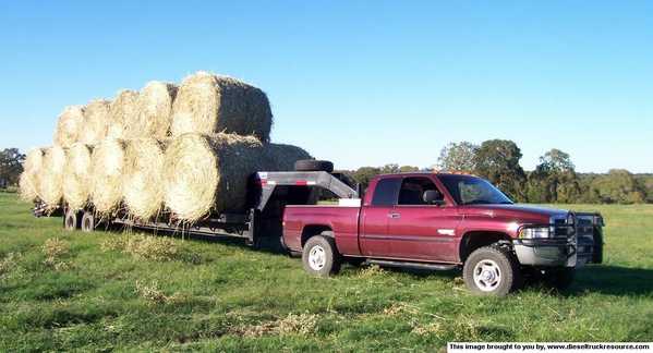

I don't know how many of those 17 rolls of hay you'd have to take off if you take any blocks out That's a good picture.
Thanks! That was a bit of a load.
The trailer is usually enough to bring it back to level, just wish I could get it to sit level all of the time. I figured by now it would start getting worn in and sit lower in the back, but still not doing it.
