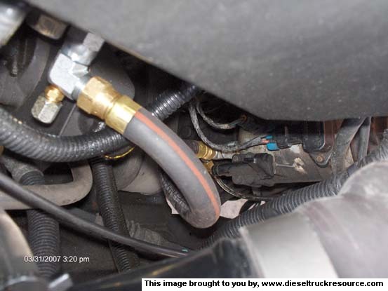

I am looking for a picture of the big line kit that replaces the stock line between the Fuel Filter and the Vp44. If you have any, please share. I have a bunch of fittings and 1/2" line and i am wondering if i have the right fittings or enough fittings to make a kit for my buddies truck. Thanks

I don't have any pictures. The fittings on mine that I got from vulcan had two 12mm to -8 JIC fittings. The line is about a foot or 15" long had two 90 degree fittings to -8 JIC female fittings. In reality, you don't need any more than -6 line, since the hole in the 12mm fittings is only about 3/8".

same here got mine from vulcan also got a T fitting from them to use on my fuel pressure gauge. T fitting is about 18" prior to the injection pump. pending weather tomorrow and what I'm doing and if my battery eating camera is up I will post a pic of mine.

I have a coupla pics on page four in my Gallery.
Click on "Clunk", View Public Profile, then Member's Photo Gallery.

its a tight squeeze for a pic
