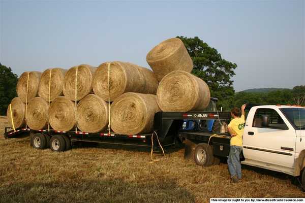

IMO, i would do -
Super Phatshaft 62 (upgradeable to twins later)
Adrenaline
Mach 4's
Studs (on stock head and gasket. i used to run a sps 62, and trust me, you'll need them)
With a built trans of course. And for your concern about needing less than a 100 hp injecter while towing, i pulled loads like this with a 220 hp injector:
Trailer and load weighed in right at 30k lbs.
