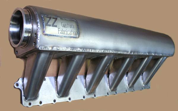

Here is another on one that has me drooling..... I think I might do it.

That probably be a good day for a smokey dyno bash. That zz manifold is pricey. Brett and I are building one for our truck. I'll snap a picture and see if you want one. I might be able to swing another 12v head into the shop to hack off that intake plenum. I'll keep you up to date. Worst case, ZZ has one Brett does some pretty nice work.

Please correct me, but it seems that these styles are only a little better than stock in that the highest air flow will be available to #1, and slightly decreasing all the way back to #6. I understand how the stock built in has angled ports blocking flow to #6, and my understanding is the flow issue to #1 is distance from incoming.
I've been thinking about this myself for a while- leaning toward a header style as well by theory.

justme, First off, just try and port the intake side of the plenum. You'll see why you cut off the plenum. Both #1 and #6 are very restrictive. Secondly, put you fingers in there and pretend that your a molecule of air trying to get into those cylinders. Now try to cram in lots of air.

Swamp you going to run an intercooler? That ZZ intake is set-up for an intercooler. Did you ever put any miles on that whizzy new motor of yours?

No miles on the motor yet. Might make a few phone calls and find a milling machine and chop off that big ugly piece of iron on the intake side of things......

Looking at those intakes, I wonder where the injector lines going. I'm going with hand bend lines (custom fit), another disadvantage of the 24v head.
