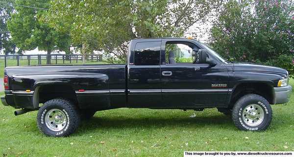

The truck
It has a 7 inch bull hauler stack on it now/in the vids. It smokes a little
This was the Richmond, Ky pull. He got 1st place at that pull, and I personally drove the truck there myself with the blocks, and weight all on/in it. Took 1st, and drove it home.

As you can see, it no where near cleans up the smoke. For a street driver, I would put 191's in it, tune the AFC(its gutted), and call it good. The 191's should clear up a lot and not lose much power at all, and the AFC would help keep it cleaner on the low end of things. Its a pulling rig though, so smoke is not a problem He is running the SPS68 both of these pulls. It spools a little faster than the hx55, but it doesent clear up the smoke, or pull as hard. It might be a better daily driver charger, but the HX55 is better for pulling. A full billett goerend 47re puts the power to the ground. The pump is the factory 180, and has never been to a shop to be flowed. It has a new factory lift pump on it, and a cheap fuel pressure regulator set at 40psi.
