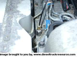

Old Jun 18, 2007 | 04:16 PM
RAF's Avatar
RAF
Posts: 253
From: Egg Harbor City, NJ
I used the Boost Bolt.
