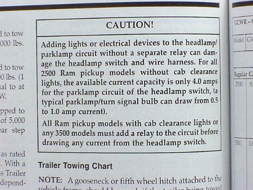

When making modifications to a design, it is wise to ensure the change won't exceed the capability of any part. In this case I am concerned about the headlight switch. My manual warns that there is no spare current available on 3500 trucks with cab lights and dually fender clearance lights, and that 2500 trucks without cab lights have only 4 amps available.
Another advantage to the relay approach is that the added light will get all of the vehicle's voltage, where the diode method will reduce the power by .6 volts.
