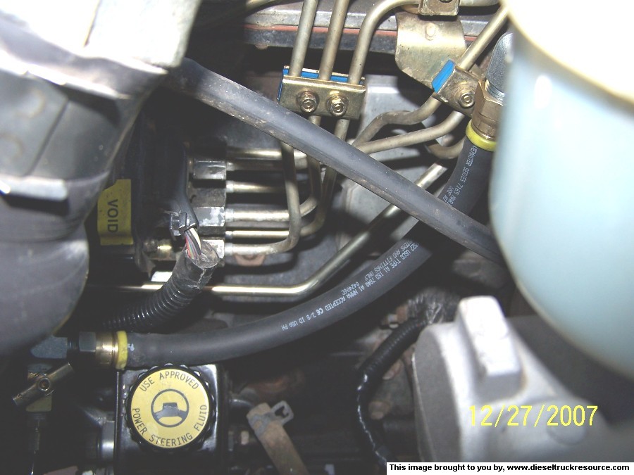

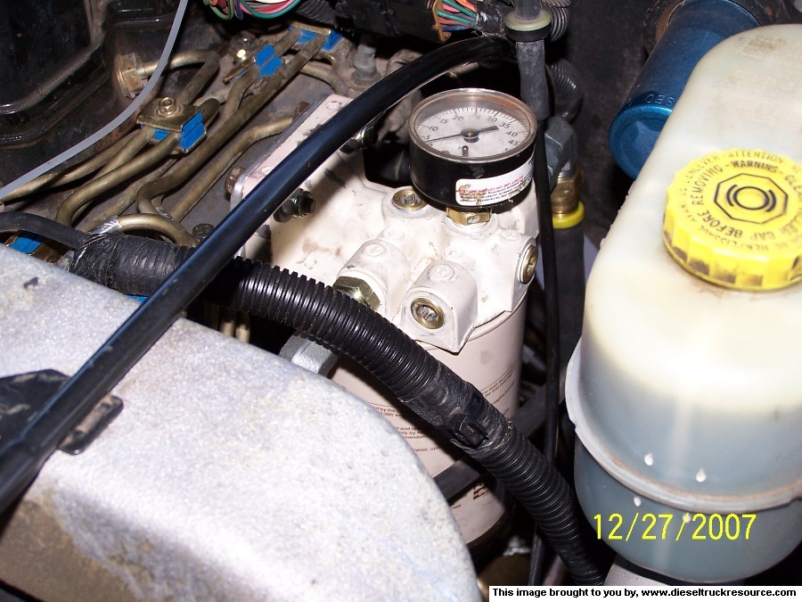

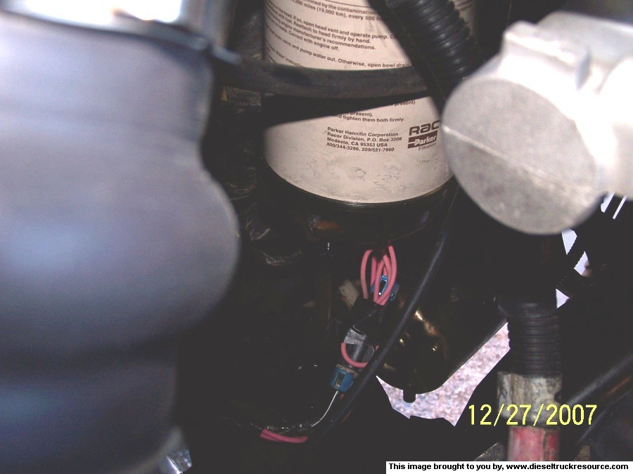

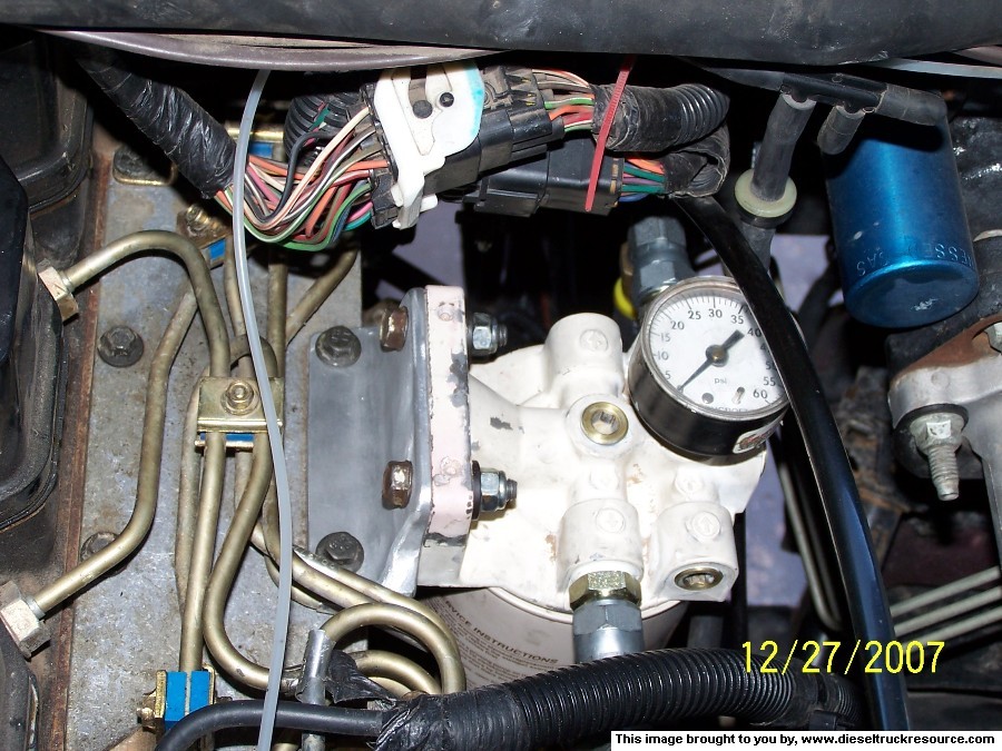

I removed the stock FF and in it's place, I installed a Racor 690R1210 fuel filter/water separator complete with a 200 watt heater and a water in fuel sensor, except I am using a 2 micron R90S filter element. The heater plug was the same, but I had to splice on a new connector for the WIF sensor. I also added a small FP gage on the FF inlet and I now have a FP on the gage pillar which reads at the VP44 inlet. This will allow me to monitor the pressure differential across the filter--especially because it is a 2 micron.
I relocated the pressure regulator before the filter to avoid any further issues, but I really don't need to worry about leaks from the Racor because it doesn't have any tiny o-rings to blow out. The install turned out nice. Pics to come.
As far as the Walbro goes, it is running at full speed right now. Instead of a PWM or a rheostat, how about wiring in a resistor from a vehicle heater fan motor to cut the voltage in half? I might give that a try with my spare Walbro wired to a 6 volt golf cart battery and see how that works.
Truck is back up and idles fine. Road testing is next.

I traded my friend some stuff for the Racor and filters, which he originally bought new off eBay. I made my set-up from a Vulcan big line FP relocate kit, little extra fuel line and a their FP regulator. I have a cleanable 140 micron screen before the Walbro and a Draw Straw also from Vulcan. The Walbro 392 was purchased from eBay.
I have about 200 miles racked up on my Walbro and the 2 micron Racor set-up. Everything seems to run great. Idle FP is 14psi, cruise is 13psi, and full power is 11psi. Again, I relocated the regulator before the fuel filter and not at the VP44 inlet as originally intended.
This gauge monitors FP before filter, while the in-cab Dipricol monitors FP at the VP44 inlet. I plan to replace this gauge with a bottom mount style connected with a 45* elbow (to clear the oil dipstick) so I can check FP without crawling on top of the engine.
I ran out of fittings so I used 3/8" line from the FF to the IP.
