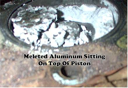

I wouldn't even slide the stock plate forward without a pyro.
If you don't want to install a pyro leave the engine stock.
The picture below is from a 12 valve whose only mod was sliding the stock plate forward, no pyro.
The owner drove it quite some time with the mod and no gauge till one day towing 4000 pounds up a slight grade with a head wind it nailed him. Engine still ran, but not very good. Repairs totaled about $2500.
You can drive like grandma if you don't want to install a pyro but then what's the sense in jacking up the hp?
