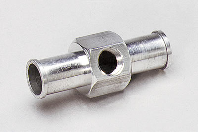

I had the same problem trying to find a way in with my AirDog. I went down to a race shop and told them what I was doing, and the guy gave me everything I needed. Just make sure you get the right size fittings.
Here's how I did it:
http://static.summitracing.com/globa...s-670350_w.jpg
http://dodgetruckworld.tenmagazines....mer/227828.jpg
You could also use an inline tap as well:
http://static.summitracing.com/globa.../sum-g1711.jpg
Heads up though, with my tap there my gauge rattles. It reads perfectly fine, and doesn't bounce. But I can hear the pulsations from the pump through the line. So I figure moving my tap further away with an inline tap, it might eliminate the pulsations through the line.
