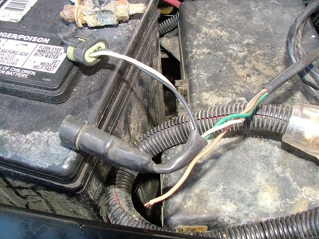

Unhooked Comp to go to the dealer. Getting ready to hook back up and notice this. Has the brown wire pulled out of the connector? Afraid to hook up until I know...

Uh yeah, thats not good. The bummer thing is that that's the plug that goes from the Comp to the factory plug. If you leave it the way it is and hook it up, your truck will go into a limp mode and give you a "Low Voltage MAP Signal" code. Those type of plug can be pulled apart with the right tool.....I think.

Edge says they'll kindly replace the harness for $150.00. Where can I get replacement pins for this connector?

find an electrical Geek and he/she will probably be able to fix it. Of find your local electronics store (not radio shack) and they should have the pins.
