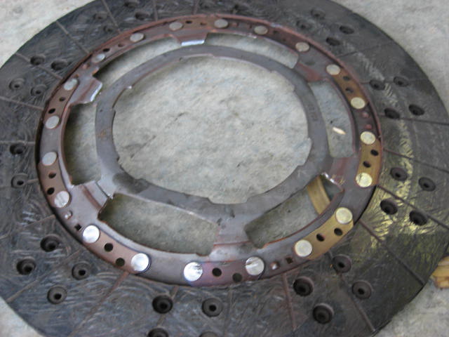

well me and dad jus got the tranny off and the clutch out. center of the clutch disc blew apart. soo. the shaft looks fine but honestly do u all think i should go ahead and get the bigger one. what r the real chances of it breaking?
If you're getting a dual disc the bigger shaft is a requirement...
