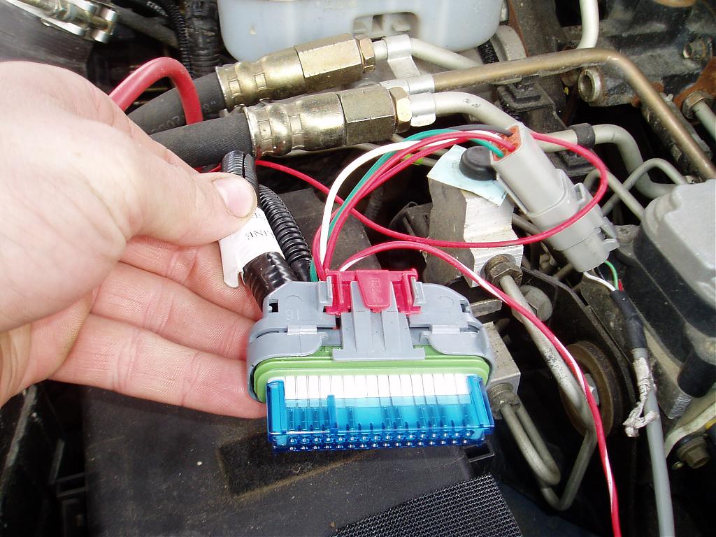

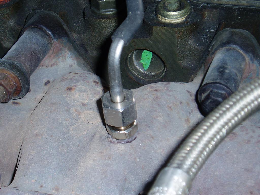

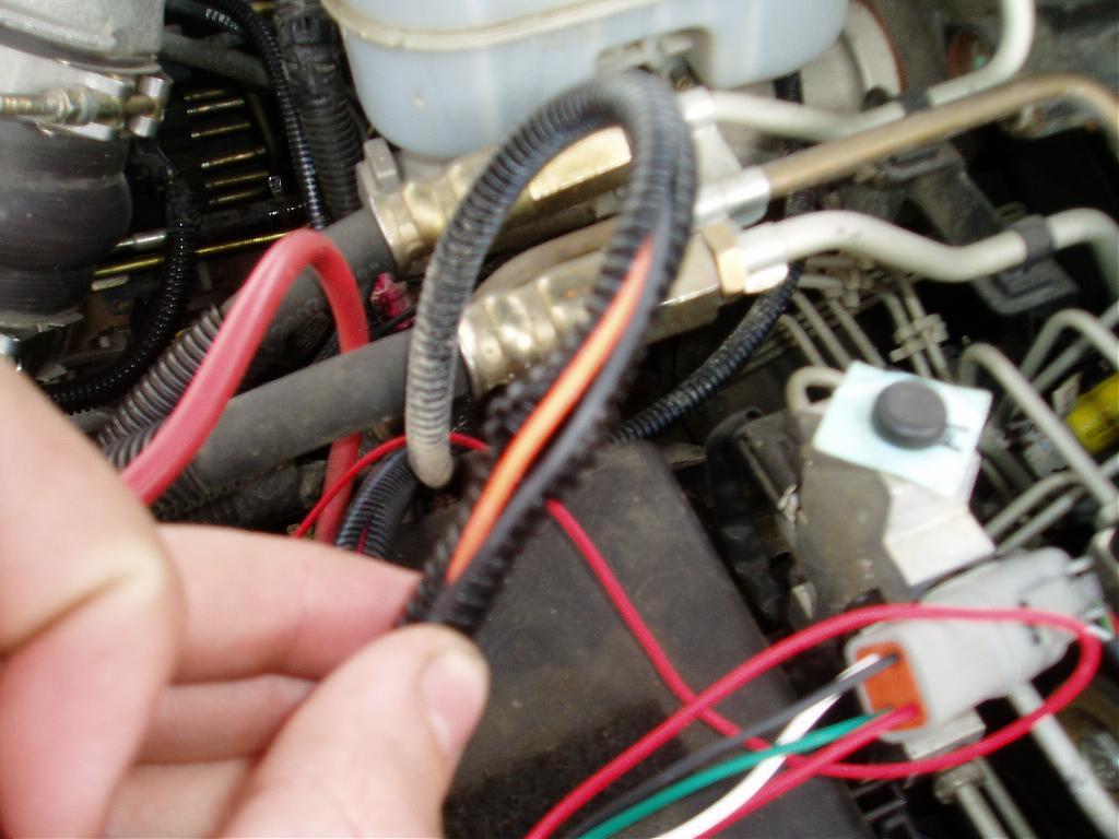

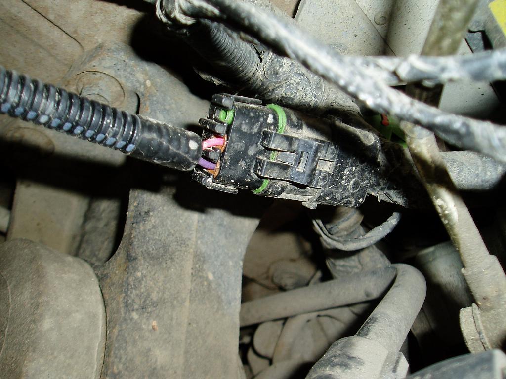

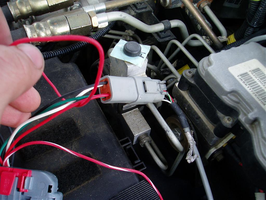

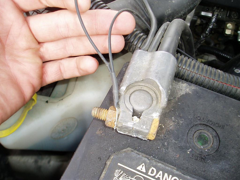

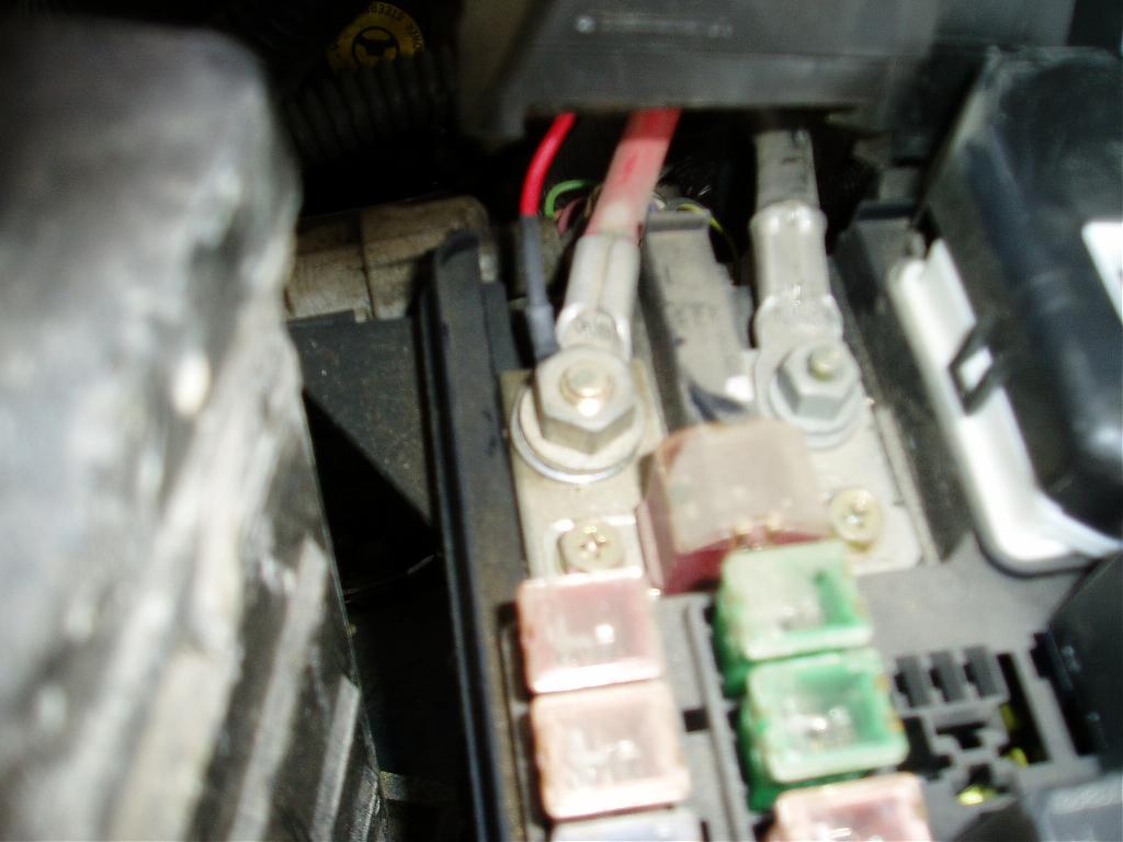

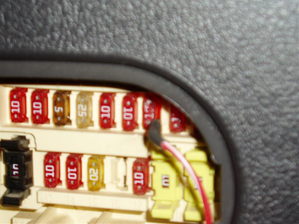

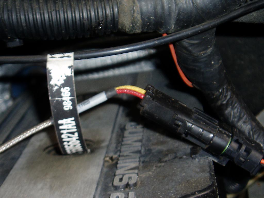

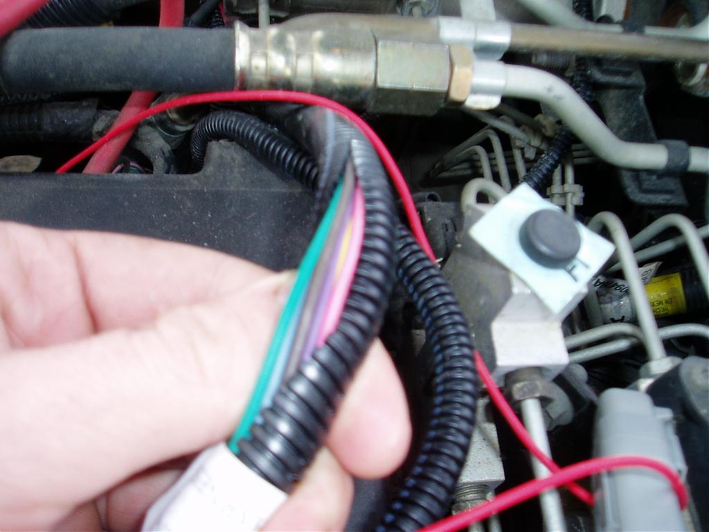

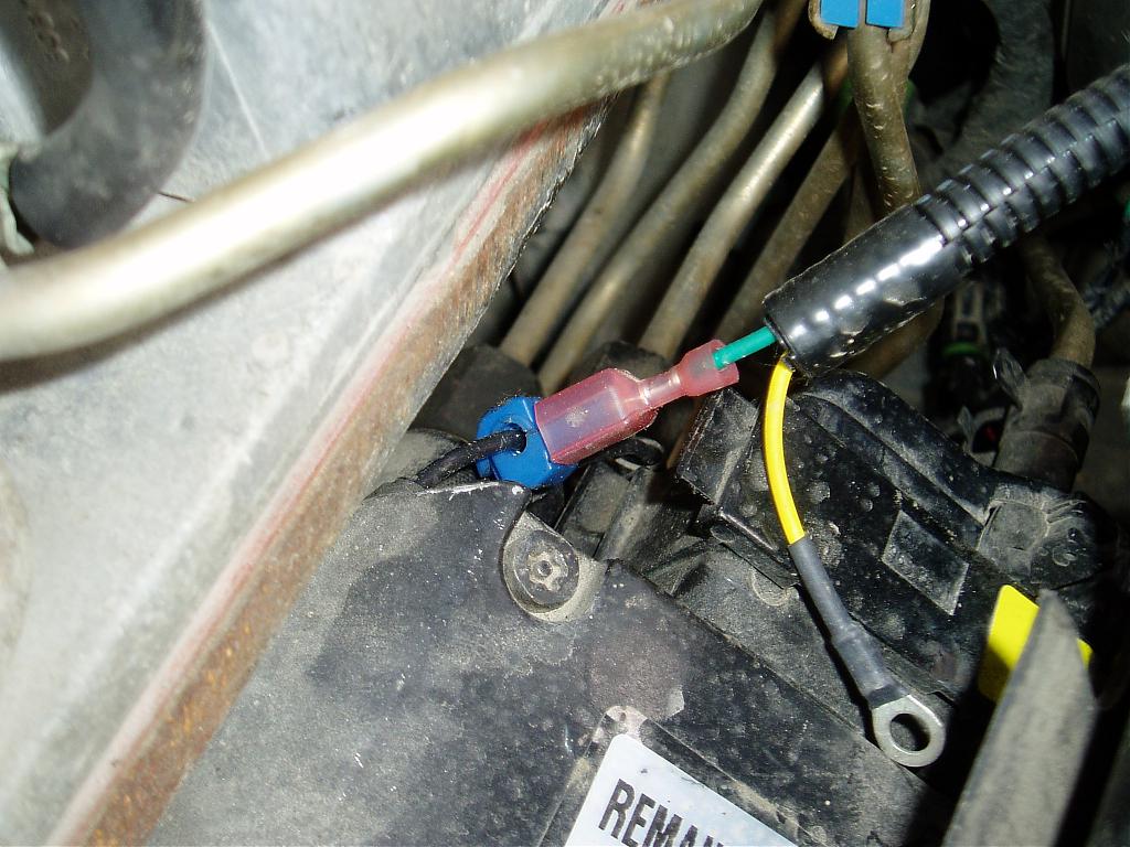

I have had my adrenaline/pulse set up installed since June 26th with absolutley no problems until today. I went to start the truck and it would sputter for a few seconds and then die. I continued to try to start it for three more times and then began to investigate. It took about 2 seconds to realize the Adrenaline was toasted the case was hot and stank of electrical fire. All the wires leading to the adrenaline were fine all grounds were good and no fuses were blown. I disconnected the main connection from the adrenaline and tried to start the truck again. The truck started fine, but things were not good, acceleration was almost non existent, and there was a check engine light. I am going to send the module to Quadzilla and see if they can help me out with this problem. I am worried that the vp44 may have suffered some damage, but I am still not sure. Any info would help out.

More pics just showing that none of the wiring is damaged.

Unhook the map sensor & reconnect your stock wiring to the map sensor. If the module is unplugged, your ecm will throw a code with no signal.
Old Aug 13, 2008 | 11:13 PM
mrclean's Avatar
Posts: 328
Remove the unit and put it all back to stock. Reset the computer and it should be OK to drive until Quad helps you get it sorted out.

VP-44 and ECM are fine if wiring is OK! CEL will go out after 5-10 starts if problem does not reoccur.
You need to Unhook Adrenaline at MAP Sensor and at the Data Port. This gets you back to stock...as suggested above. Send the ADR in, but call and get a Return Authorization first!
There is a resistor inside that cracks.... from too much heat, I'm assuming. Quad has not commented on it, other than saying they can't duplicate it, so I'm not sure about the fix.
It has only happened to half a dozen or so CTD's so far?? I'm one of them.
RJ
