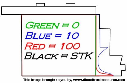

https://www.dieseltruckresource.com/...5&d=1244205658
theres a link to a picture of a good "template" if you want to call it that. you will be able to see that a 100 plate is very close to a 0 plate with the difference being that a 100 plate limits your low end fueling more. a 100 plate will give you more power like infidel said. but without some more supporting mods, like more air, your EGT's will be insane. a 10 plate is very controlable. and you can always grind a 10 plate to a 100 plate if you dont like the 10 but you cant go the other way.

If the AFC is the same for both plates, regualr driving won't change with it.
10 plate defuels on the top end, which I never liked. Thats whey I run 0/100 plates, stronger top end. AFC controls the bottom end, so 0/10/100 doesn't matter a whole lot in that respect.

If you put in a 100 plate, it will help out your top end, but it won't extend your rpm range. The 10 plate defuels the top, the 0/100 doesn't, so you will have more power up higher.

It all depends on plate position. You can make the 10 fuel harder than the 100 by having it in a more forward position. If the deepest part of the 10 plate is in the same place as the deepest part of the 100 plate, the mid range will be the same between the two, but the 100 will have the better top end.
