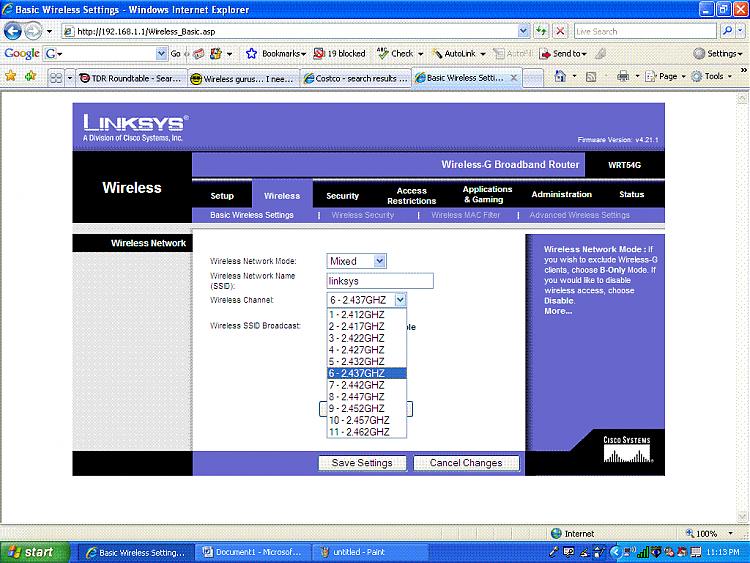

If sounds like it could be RF interference. You could place the laptop close to the Linksys and see if it still occurs. If it does I would move them both to the other side of the house and see if it still occurs. Also my cordless phone sometimes interferes with my wireless network. If I have the phone handset near the PC it often interferes with the signal of my laptop. Depending on results you could try changing the “wireless channel” being used. If you go to your web browser and type the IP address of your default gateway it will bring you to the login of your Linksys. If you didn’t change the password I would try “linksys” or something similar. I believe you leave the username field blank. Keep in mind that you should do this from a wired PC because your wireless client will likely loose its connection. You may have to fuss around with the laptop wireless client software if you change the setting to get it back online. I have never needed to change mine but your symptoms sound like it could interference with something in the area. It could be a neighbor, or any number of things.

The most commonly used residential wireless channels are 6 and 11. Try a channel like 7 or 3. I would still suggest updating firmware, it is like changing the oil and if done right will make things work better even if you don't notice it.

Because wireless channels overlap, there are really only three "clear" channels. They are 1, 6, and 11. They are only clear if nobody nearby sets up on any of the other channels. Since most people don't have the first clue about this, you can't always run on one of the three prime channels. However, you should always try those three before you try any other channel. If you have more than one wireless network, it is really important to put them on these channels.

OK. I changed the chanel and moved the atennas and the cables behind all the computer stuff. So far it seems to have helped. I will know tonight I'm sure. THANKS for the help guys!!!
