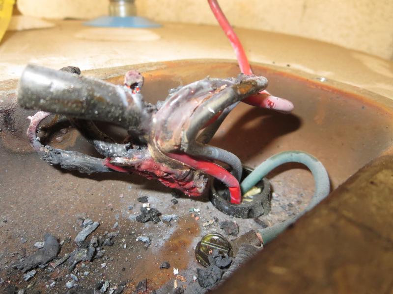

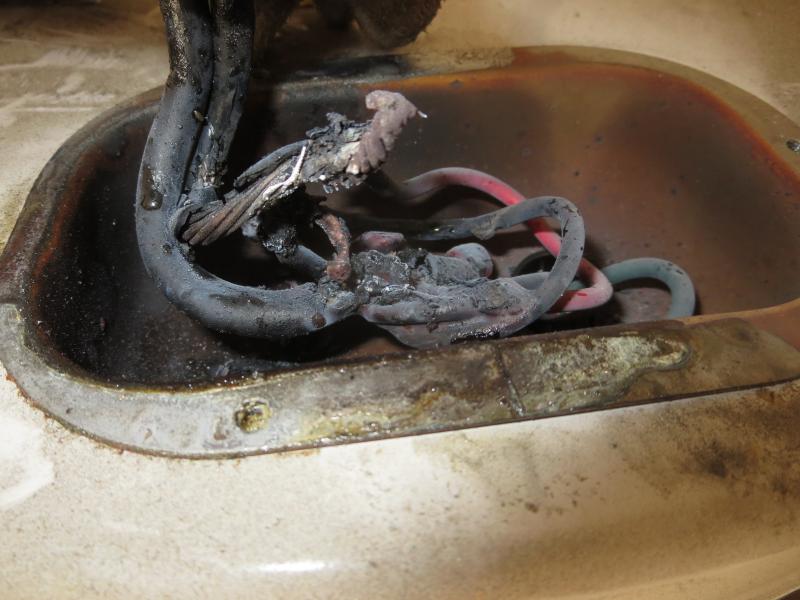

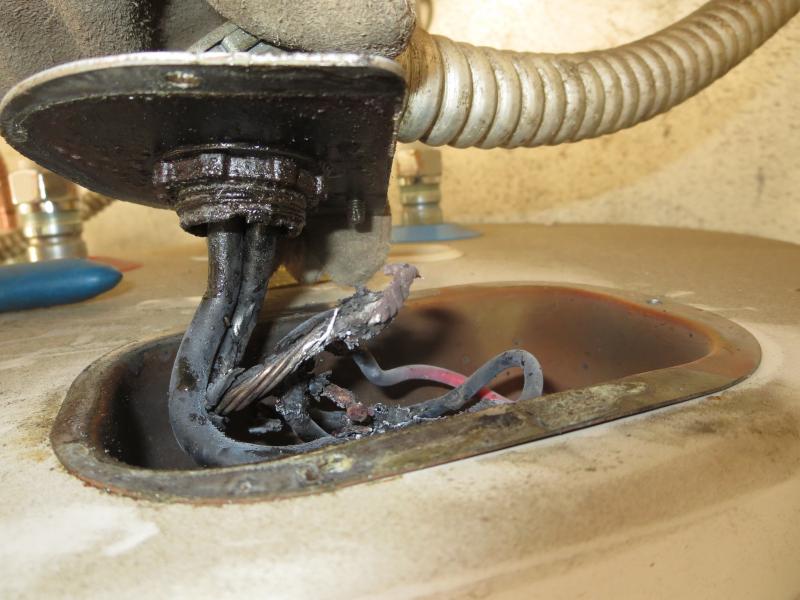

I got an emergency call about a week ago, the tenant had no hot water, so I got there and checked the usual circuit breaker and then pulled the thermostat cover to access the internal circuit breaker and the first thing I noticed was the nasty smell of something burned up.
So now I am thinking this is going to be a bit more than just replacing an element, I went and after removing the breaker panel cover I identified the breakers and shut off the power.
I removed the wiring access and found I had a nasty burned mess in my hands, so after taking pictures for documentation I carefully cut away the wiring so I could determine what had happened.
This apartment building was built back in the late 60's, when all of the wiring in the building was aluminum wire, aluminum wire has burned down many houses here in California before it was outlawed.
Besides aluminum and copper being dissimilar metals, when when passing current they both expand and contract at different temperatures, causing loose connections leading to overheating leading to fires among other problems.
This water heater was replaced about 1 year ago by one of the other guys in the maintenance crew however he is not an electrician.
It appears there was a loose connection between the aluminum wire and the copper pigtail of the water heater under one of the red wire nuts, the connection started overheating to where it eventually got so hot that the THHN insulation melted on the wire to the water heater and since the wires were crossed when they were just bunched up, the 2 conductors got shorted together resulting the final arc that broke the connection.
See how all of the old rubber insulation has melted away?
Part of the disintegrated wire nut in behind the mass of wires.
Here is the melted mass up close,
I cut this out and I left it on my bosses desk just as a reminder of how good I am at repairing things and how it seems like I can always repair the impossible.
To repair this I cut out all of the wiring down to the top thermostat and replaced all of the wires using new stranded THHN.
Since the supply was one continious pull from the breaker panel I cut off 6" and terminated it in a 4-11/16 box and a new section of 3/4" flex from the heater to the box.
The 10-AWG connected to the aluminum wire was with split bolts and anti corrosion paste.
http://www.alwirerepair.com/whats_the_problem.htm
Just thought would share this adventure with you.
Jim
