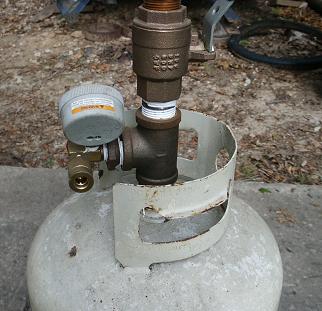

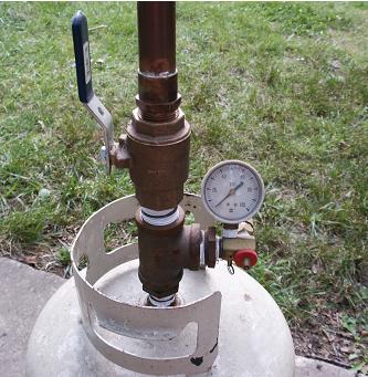

Combination air tank / Cheetah inflater.
You need a potato gun adapter for the end of that thing.
Those Cheetah's are very expensive. An equal sized one to that would be over 350$! Did you just use a big ball valve? Cheetah's have that weird flapper with a O-ring on it to let her rip all at once. I was just wondering how its working out for you.
Old Jun 29, 2008 | 09:49 PM
93w250's Avatar
Joined: Jan 2002
Posts: 135
From: Parkton, MD
Yup 1" ball valve, tee etc. All off the shelf.
I've used it on up to 16" tires. Pump it up, put the compressor air chuck on the stem, insert the Cheetah between the rim and bead and open the valve. Oh yeah, don't forget to hold on tight.
Attached Thumbnails old 20lb propane bottles-pict0002.jpg   old 20lb propane bottles-pict0003.jpg   old 20lb propane bottles-pict0004.jpg

Does anyone know the burst pressure on those propane tanks? I guess 120 PSI is safe when using them for air but I don't really know. Doesn't propane sit at about 70 PSI at room temp?

most propane components, tanks included, carry a safety rating of at least 312psi.
Service pressure is 240 psi. Propane sits at around 125 psi at room temp, so 120-150 psi is no sweat. Our fill pump at work runs at 220 psi.
