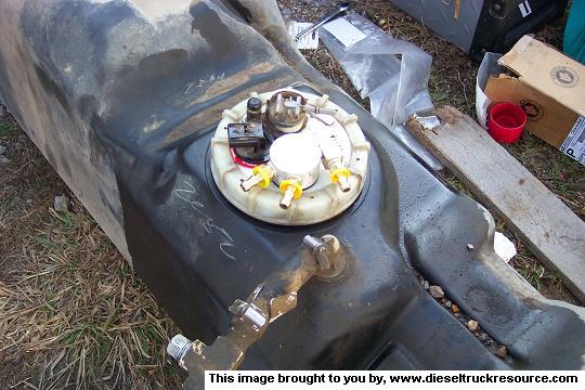

When we were at the "ranch" the last time, you were telling me about a modified pick up tube to replace the factory piece in the tank. Since I now have the FASS and all my gauges taken care of, I want to do what I can to improve the fuel flow. Was it a vulcan straw? Also, how much of a pain was it to replace? I know the tank has to drop, but other than that?

Unless you have the in-tank fuel pump, you probably will not gain much by going to a "draw straw".
Rowland has done his (err...Brian and Tyler) and I'm sure he and Dan will let you know the pro's and con's.

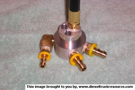

Add one PSI and that is what my truck runs at.....i wouldnt mess with it personaly......BUT if you want a custom draw straw like Rowland got....let me know and ill put in a call to Eric for ya. Rowlands had the FASS return machined into the Unit......something i was banging around with Eric a few months ago.....

Wayne - Draw straw is not needed and will not really benefit you anything.
I did it for two reasons.... 1) had chance to be guinnie pig for 'Draw Straw' with FASS return line attached....and the main reason 2) Was very curious as to condition of tank and filter screens in fuel module at 100,000 miles.
I think Charlie, Brian & Tyler will agree that the stock Dodge system looked excellent. While a bit complicated, it seems to do the job with 300,000 - 500,000 miles in mind and does not need improving! Tank did not need cleaning either...possibly a result of burning BIO 20?

I agree that the draw straw is probably not needed... The stocker seemed to be just fine and I don't believe there was much restriction at all with that unit other than the mesh screens... I imagine if someone were to get a few dirty tanks of diesel than those mesh screens could get dirty and possibly reduce flow....
thinking out loud, but when that fuel canister fills up I believe that there would actually be some reverse flow through the screens to keep them clean?? maybe??
