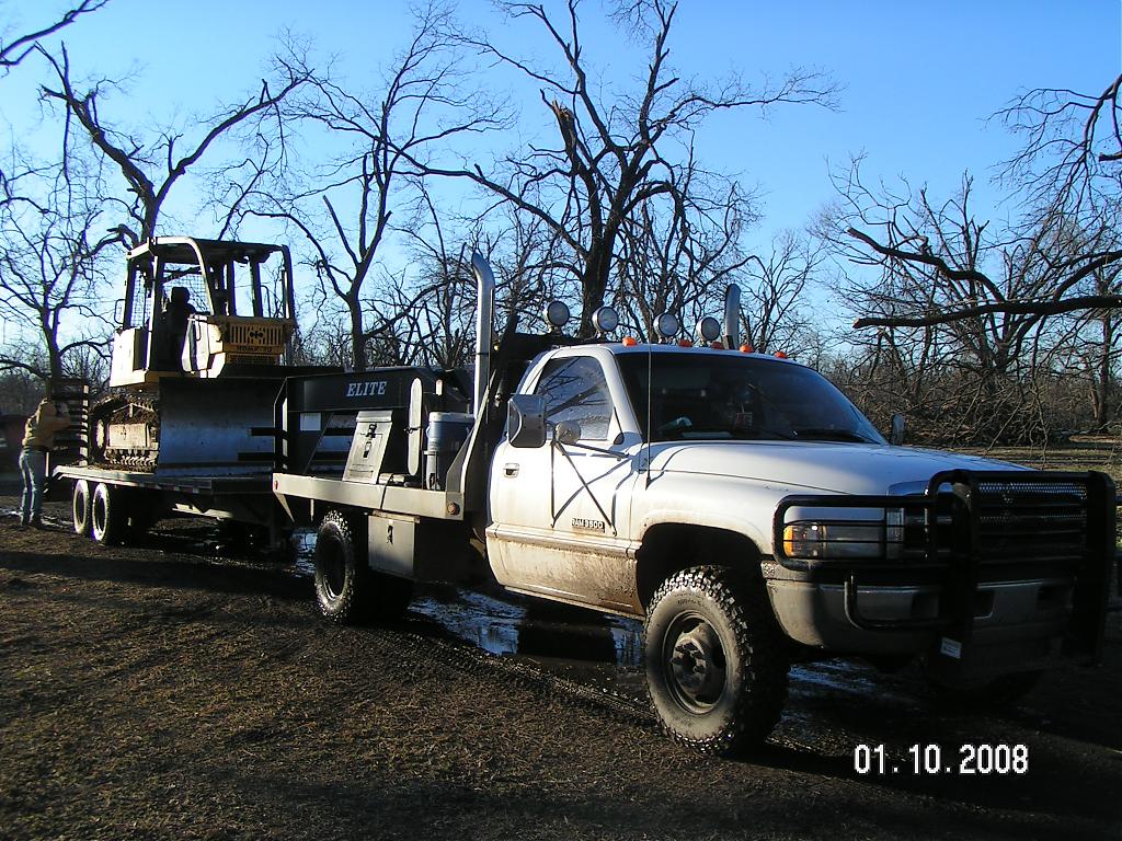

1996 Ram 3500 12 valve. About a year ago, it showed oil in the radiator, so I changed the oil cooler. Flushed all the oil out of the cooling system I could get out, and things were fine. One thing I noticed ever since then, temperature would not raise during normal driving. Only time it would actually come up to the middle of the gauge (where it used to run) was when hauling a backhoe or dozer with it. Took forever for the heater to start blowing warm air. Now, probably about 7,000 miles later, it's using oil again. And again have a radiator full of oil. What in the world is going on here? Head gasket maybe? Any ideas? I'm stumped here. I need to figure it out, I've got other trucks I can drive daily, and pull equipment with, but this is also my only welding truck. Any ideas much appreciated.
