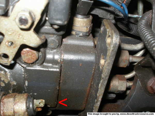

[IMG][/IMG]
Yeah, if it's not that return line it's probably the seal between the pump head and body. Really not a DIY job.
Dave, is this where the seal is? I was waiting on my pics approval when I read Darels thread. Mine has a very small leak, like one drop per minute. Its coming from the bottom side so I cant see for sure. Could it maybe be tightened?

Dave must be busy, but that's where my leak is. Mine originally started out as just a drop every few minutes, now it's almost a stream. You might want to keep an eye on it.
When I picked up the seal kit today at Mid-South Diesel Services, I talked to Steve there about the problem. He said the theory is that, on these older trucks, the rubber in the seals kind of "set" on the previous fuel blend, and since the ultra-low sulfur stuff started being sold in the fall, the different aromatic blend in the new fuel is degrading the older seals. He thinks that if we replace seals now, while using the new fuel, we shouldn't have further trouble (Steve, if you're reading, I hope I'm paraphrasing correctly). At any rate, he says they're starting to see lots of this kind of leak in older trucks (like mine).
