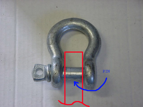

As far as pulling in forward using the trailer hitch, there were some suggestions for how to connect the tow strap. Would it be safe to buy a very large shackle and putting the pin for it through the hitch-pin in the receiver? This would transfer 100% of the load to the hitch-pin hole, but would that be safe? Or would be any more dangerous to the hitch than just inserting the hitch pin with the tow strap looped around it?

I suspect that if you bought a shackle large enough that the pin diameter would be too large for the hole.
When I am pulling the way I am, I use a half inch chain of about 3 feet long with chain hooks at each end. Chain capacity just over 5000 kgs so doubled it is over 10,000 kgs. No way I can break that. The gap in the hooks are a perfect fit for the thickness of the receiver and I hook both of them on the front of the receiver. Being such a good fit they never fall off. The chain goes thru one loop of the nylon strap. Have been watching the strap closely for damage such as cutting from the chain but so far it's good. The chain diameter is large enough not to damage the strap.
