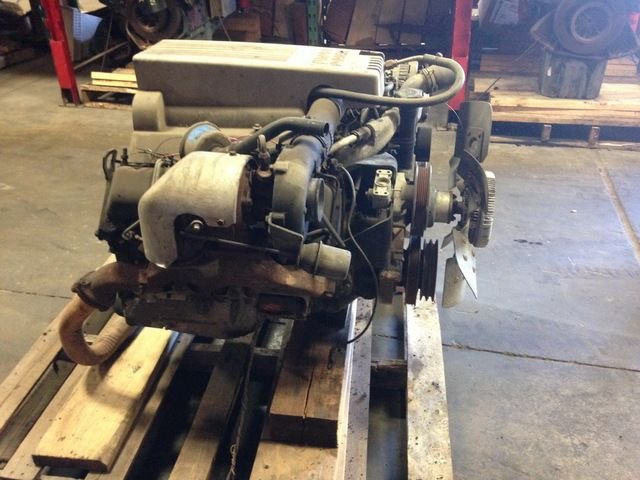

would this be a good swap it is a
GM 6.5L TURBOCHARGED DIESEL
but where would i find a transmission
Old Oct 14, 2020 | 02:58 PM
Fordzilla's Avatar
Joined: Oct 2002
Posts: 1,074
Likes: 366
From: Conroe Texas
Those are known for weak injector pumps and low power output...They usually used GM TH200 transmissions...Just remember a 52 year old frame likely has its rust issues and weak spots...Any diesel is going to produce more torque than the truck's original gasser; that is why I originally mentioned it and the suspension......Ben

would this be a good engine to put in
Old Oct 16, 2020 | 05:05 PM
AlpineRAM's Avatar
Joined: Nov 2001
Posts: 3,733
Likes: 264
From: Austria Europe
Well, my take on it is that if you want to do a real conversion to a modern diesel powerplant you will need to reinforce everything ( frame, brakes, suspension etc) to at least 3 times beefier than what you have now.
Or you could go for something that has the same realistic power as the stock engine, and get a 1.9l TDI at 105 hp and not overstress said components.
The clever way to go IMHO would be to either repair the stock engine or to replace it with something that has the same power and stays within the same torque and hp as the stock unit.
Do not forget that this truck was built for virtually empty roads, and low speeds. Upping the power will lead to a host of new problems.
