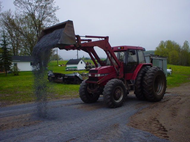

Not sure what i will do with it , take it apart , see how it works , sounds like fun to me! I Have done some work with the same mechanic before, I talked with them again , they will pay my wages and still give me the engine if it is not going to be useable , and i won't be doing a full rebuild , just what it would need to make it run again.
I have a forklift and a crane , as well as a dozer , excavator , dump truck , skidder, snowplow , atv, compactor , grader, skid steer, shovel , broom , rake , etc , all rolled into one :

sounds good!...thats alot of equipment u took ur time listing...but u didnt list pick, crow bar, sledgehammers...
