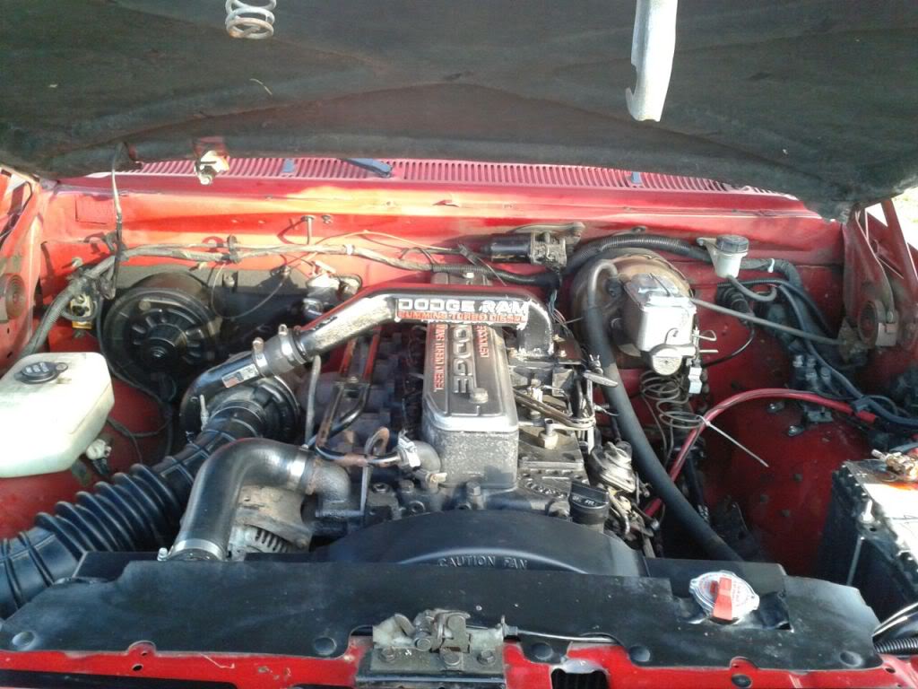

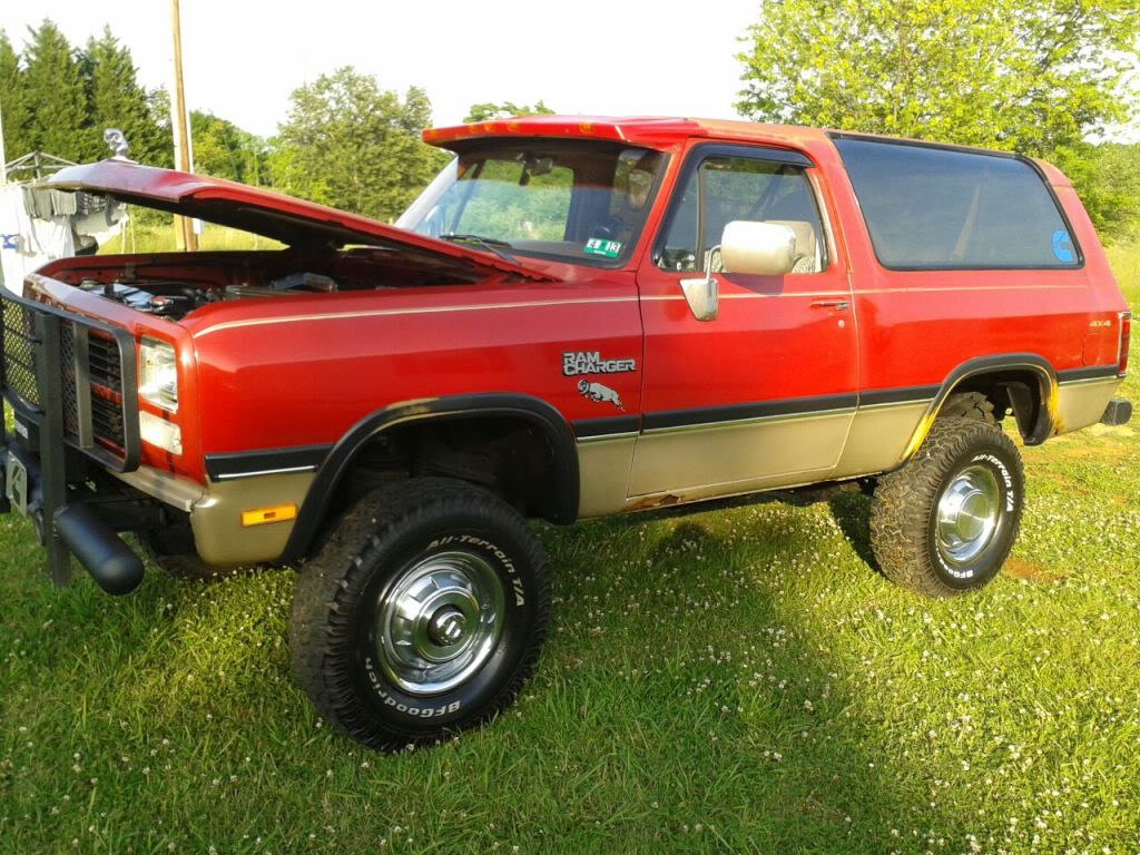

Well some final updates. Last Friday I had the front end aligned. I installed my adjustable overloads, a factory Mopar roll bar/with oem padding and covers, and a couple decals and rams head on the hood. Also since the overloads were adjustable I added about 2" in height and then added 30lbs of air in my kelderman front air ride to even it out. IT RIDES LIKE A CLOUD Other than a leaking dipstick tube which I ordered and picked up today and hope to install in the morning if there is no rain its about done. Thanks to everyone for thier help along the way. Many sources of for parts and info. I love this site

Install the tranny and T-case by myself. The hardest to figure out would probably be the little jumper harness to go from the diesel dash harness to the RC interior harness. Not that hard but took some time with the old schematics from the dealer shop manual. Most dont realize but things as simple as the dash map light. RC's in this year didnt have one. They had an overhead map light. Well mine has both. The only thing I lost with my conversion is the rear window defroster. Trucks dash harness doesnt have the provisions for it. Not big deal to me as on my other RC I never used it once in 6yrs anyways.
The problem with the VE in the non I/C pump to use a 1992-93 engine harness was a tough one but with the help of Mark Nixon (super nice member who is also VERY knowledgeable) it was worked out quickly. Sorry Mark if other members find out how knowledgeable you are and try and pick your brain as I did.

All cleaned up
Thanks to everyone
