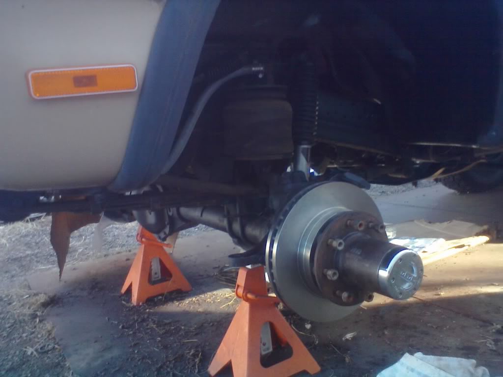

Guys I havent lost interest. Just working a lot and the fact that dad has the shop full of his trucks and me not wanting to work out in the cold. But with the weather starting to get nice enough to work outside here is what I have gotten done.
1. Made a custom steering arm (similar to Borguson)
2. Installed a new pinion seal and both axle seals in the front end.
3. Reinstalled pinion and carrier
4. Installed new Spicer axle joints, then installed the axles.
5. Installed new bearings, races, and seals in both front hubs.
6. Installed new rotors and then installed the hubs onto the front end.
7. Installed my new Mile Marker lockout hubs.
Next will be the brake calipers and pads. Then I can install the front driveshaft and tie rod with new ends. Then I will take it down the driveway to see how it feels

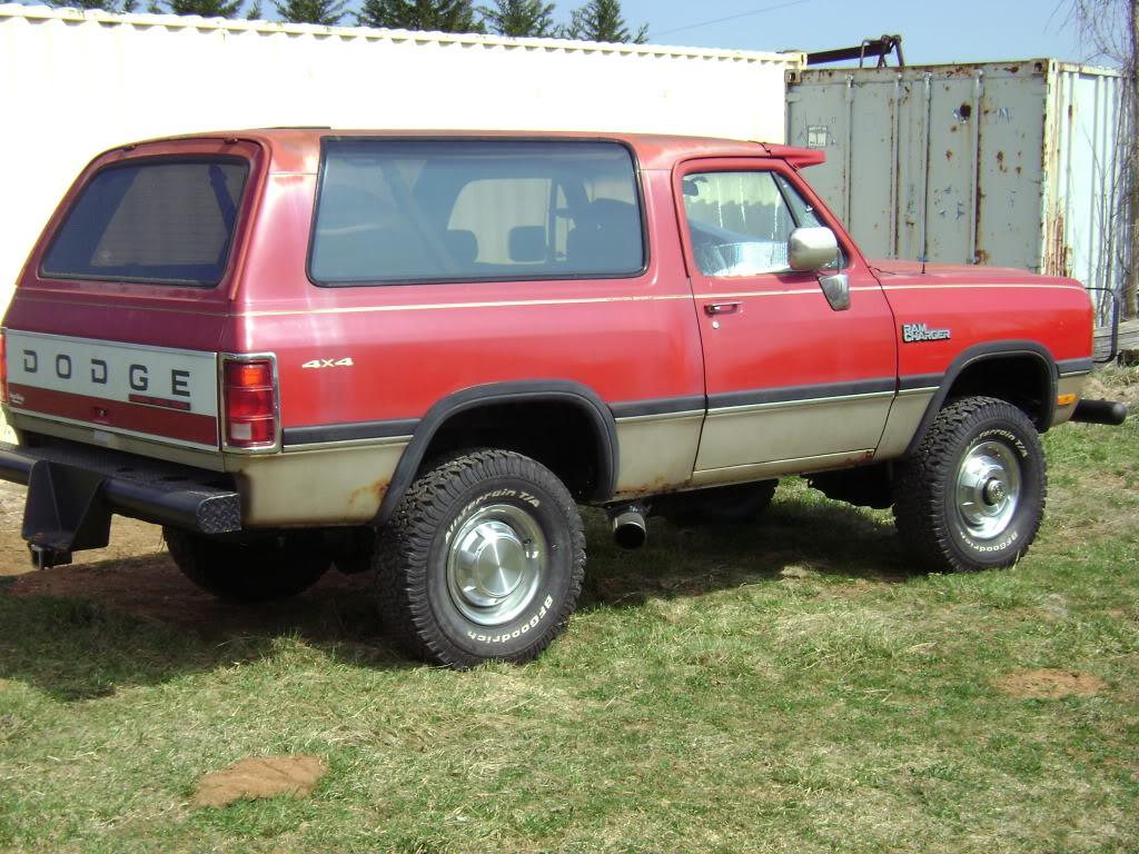

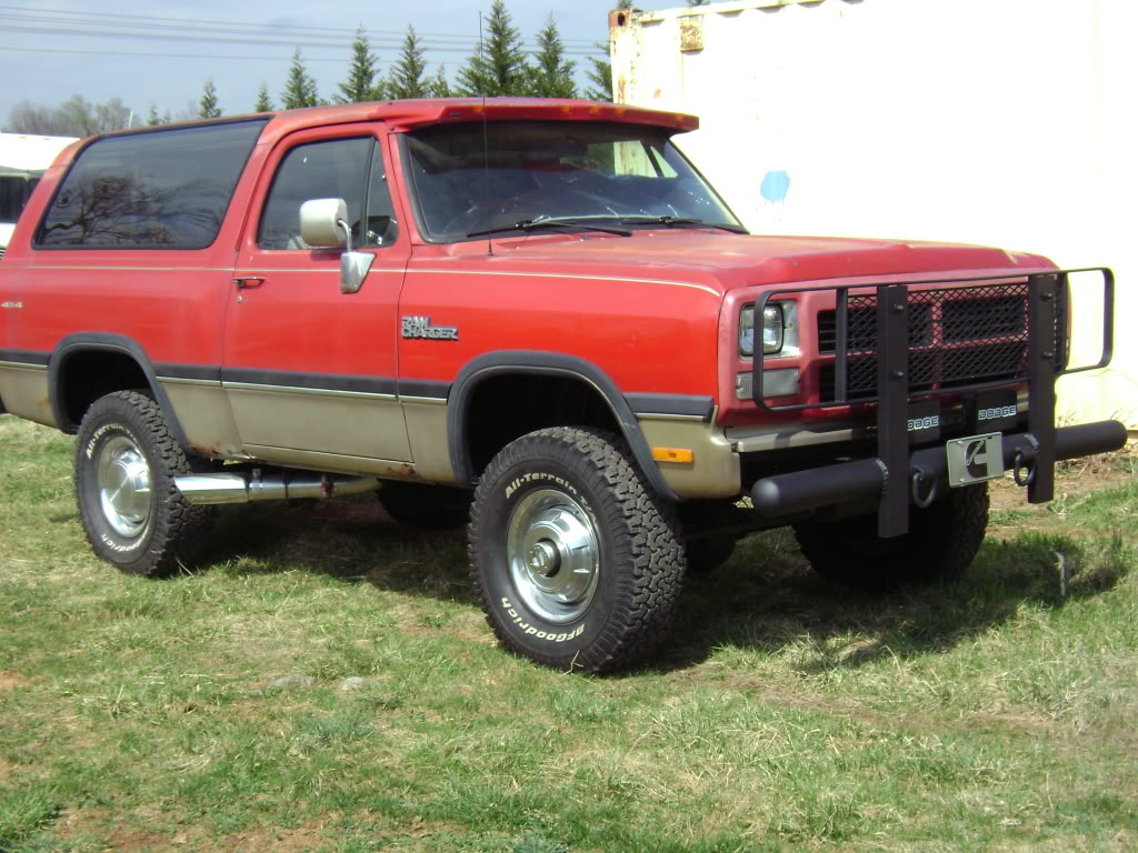

Well I didnt get to do to much to it today. Dad had me rip the front clip off his next project. Anyways, I did figure out the driverside power window motor is bad. I did snap a couple pics. Please remember this thing is dirty. It will get a nice bath soon. Thank you to everyone who has helped me.

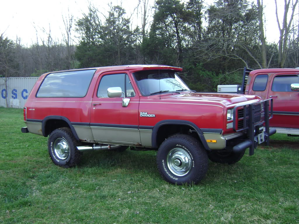

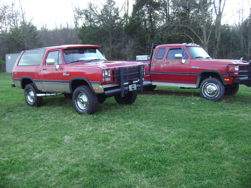

Guys I got off work today and had some blue skies to wash the RC. Afterwards I took it down the road about a mile or so. IT SOUNDS FREAKING AWESOME!!! I washed it up a bit and snapped some pics next to my dually
